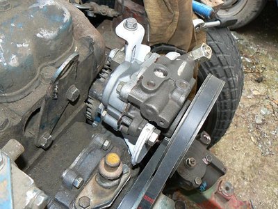

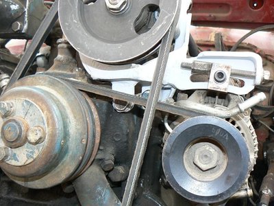

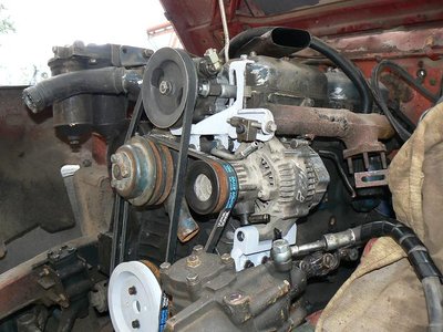

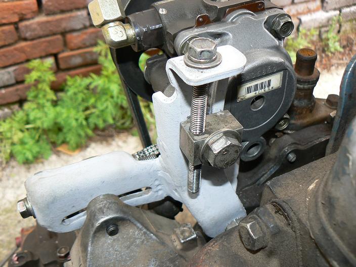

In time of the fitting servodirection was fitted
also servodirection pump and the generator unit.
As it - visible on the photos
Pump - from TOYOTA, type, what having three connecting holes.
High pressure pipe a I'm will do by self.

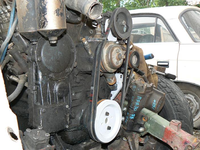

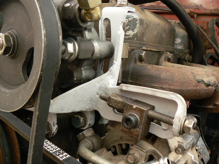

also...

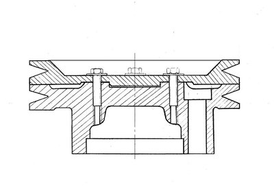

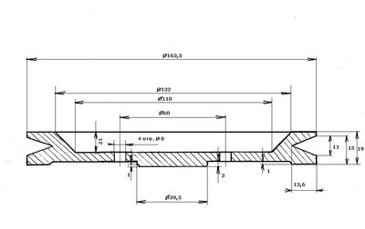

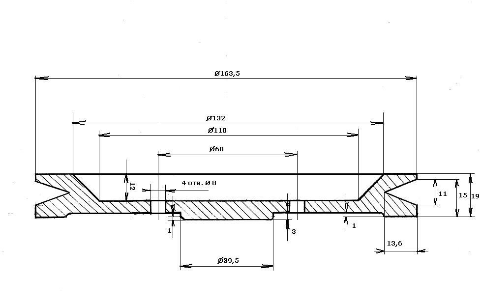

additional pulley for BRASOV...

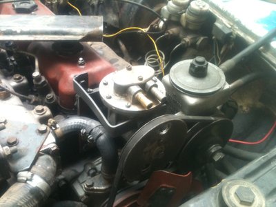

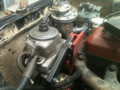

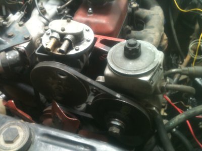

Am reusit si am pus pompa de mercedes in loc de cea pe pinion, originala. Luni ramane sa ambutisez conductele si sa ii fac o proba.
Am modificat si pompa de vacuum pe aceiasi flansa cu cea de sevodirectie si astfel trebuie sa tai un pic din capota.

SI poze
