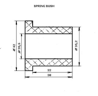

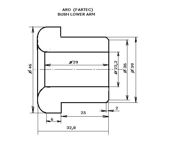

Suspension rubber bushings drawings (original)
1. upper arm.
2. lower arm.
3. rear

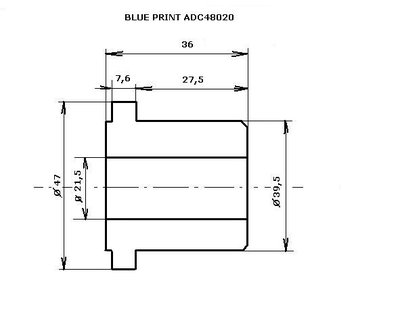

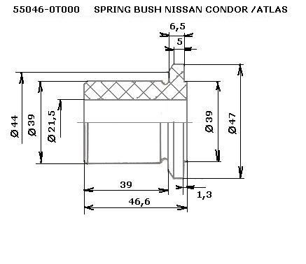

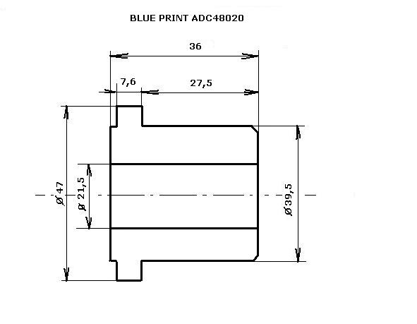

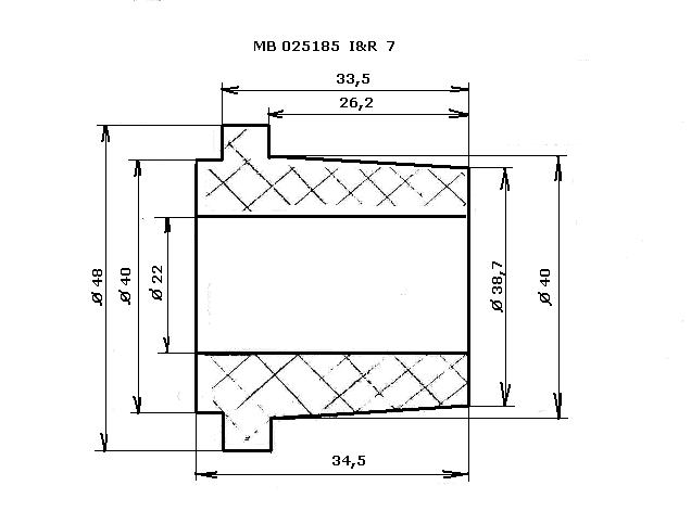

Lower arm bushing
full analog:
MMC ______ MB025185 spring bush MMC Canter II 2001-2004;
Blue Print __ ADC 48020 full analog previous;
almost analog:
NISSAN ___ 55046-0T000 spring bushes of the front end a front bladespring NISSAN Atlas/Condor (H41) 1991-1995;
further - analog for this:
RBI _______ N20H41F;
Hanse _____ HR 890 095;
Masuma ___ MP-599.
The required finalization - to make the required length (~26mm by diam. 39mm) of with help knife.
Also - Masuma is bad quality, Hanse so so.

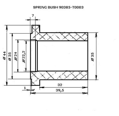

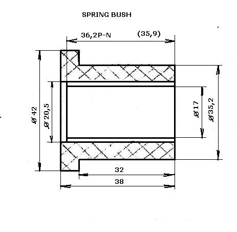

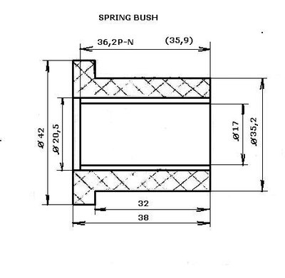

Bladespring bushing - almost full analog:
TOYOTA __ 90385-T0003, 90385-T0008 - front end of rear blade spring from TOYOTA HILUX 2005-2010 (body GGN15,25,35,KUN1#,2#,3#,LAN15,25,35,TGN1#,26,36);
analog for this:
RBI ______ T20VG02F;
Febest ____ TSB-822.
The required finalization - new steel the distance bushing
O 17 X O 22,5 X 36.
Quality RBI more good, than Febest, and, very low cost.
File comment: TOYOTA
File comment: ARO
