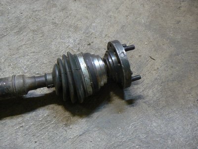

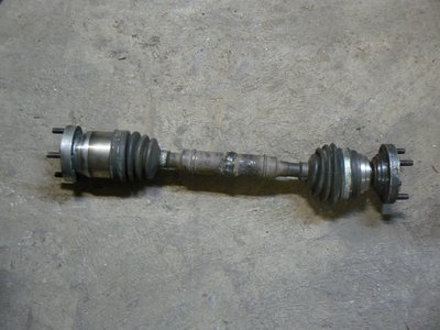

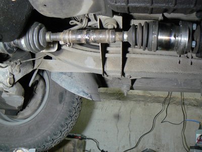

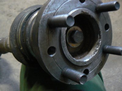

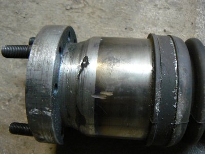

died the front propshaft. Suitable shaft from the UAZ, but he - poor quality. In a garage was a new CV joint drive shaft from the Lada Samara. Little welding and cutting, and a little lathe ...
make such device...

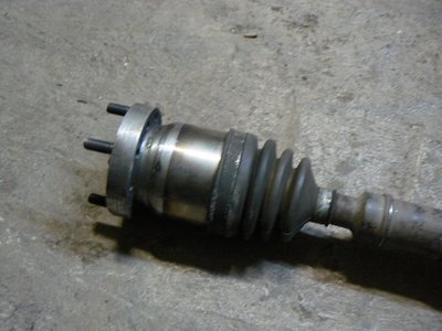

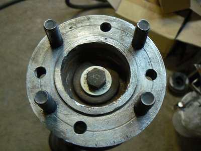

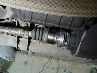

...more...

...more. Started resource tests.
