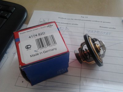

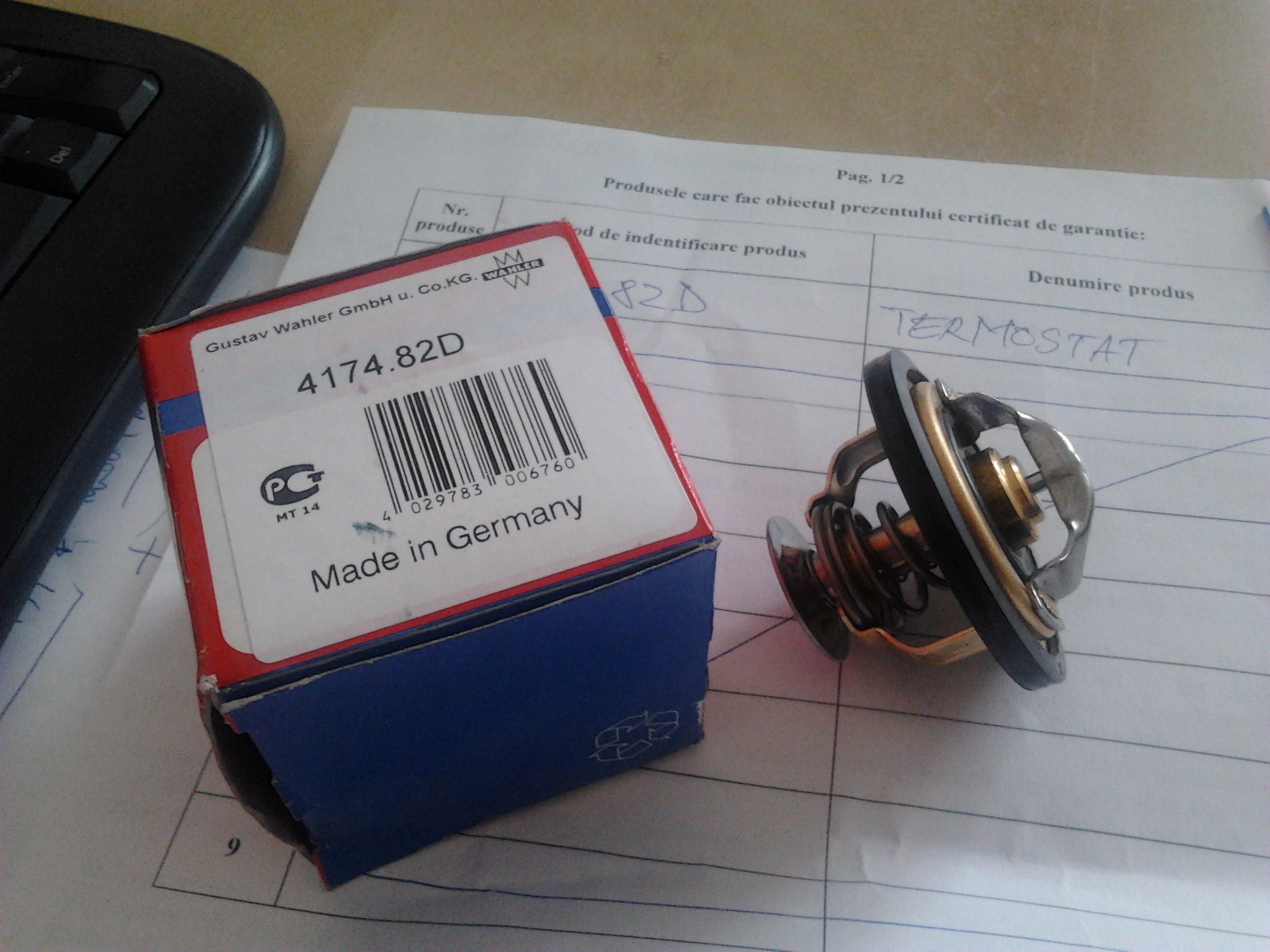

Si minunea tehnicii Nemtzesti de montat pe minunea tehnicii Romanesti.
Noroc Maxim - avem acelasi termostat! :D

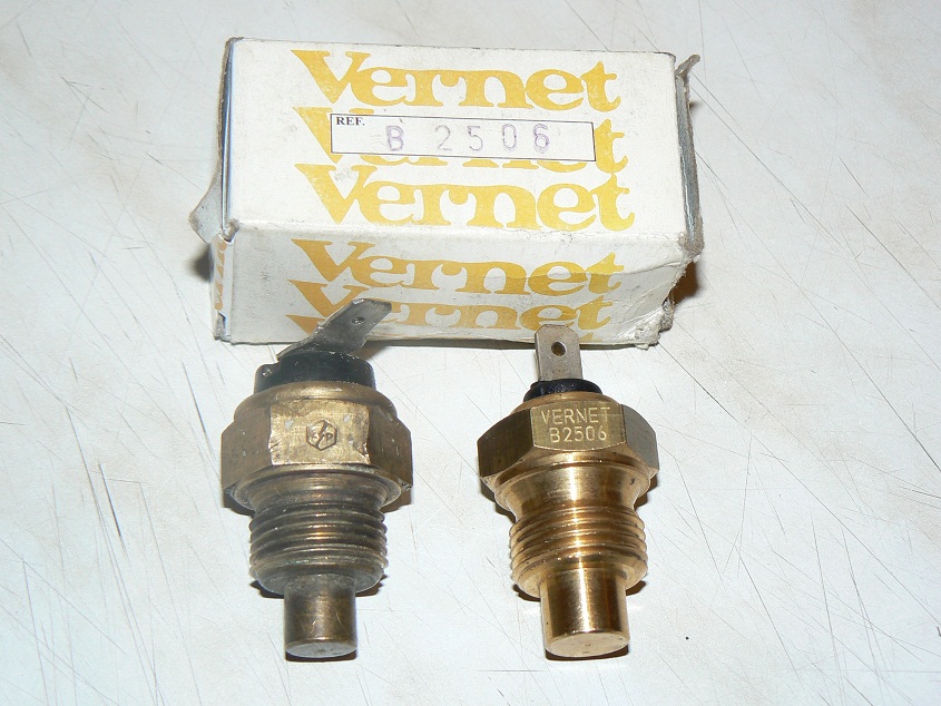

temperature sensor:
VERNET ___________ B 2506 (france)
Fae ______________ 31020 (spain)
Beru _____________ 0 824 121 091 (germany)
Beru _____________ ST044 (germany)
Commercial ignition _ XTT1 (germany)
Facet ____________ 7.3008 (italy)

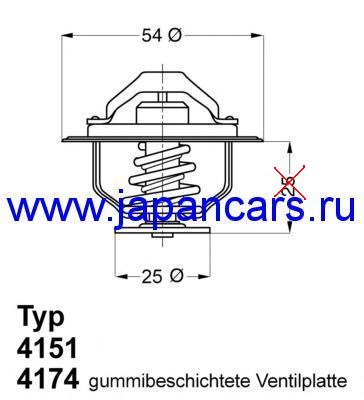

Hi. I want change my termostat because old termostat is bad. In my opinion termostat WAHLER 4174.82D is bad because, he have bad size? What do you thinking? engin D127
 Post subject: Re: Termostat si sonde apa (D127)
PostPosted: Fri Mar 15, 2013 12:26 pm
I have had no problems with the WAHLER thermostat - it fits fine, and works perfect.

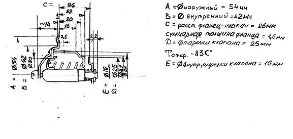

Drawing of "native" thermostat TM4-83C from Brasov engine.
You can compare.
PostPosted: Fri Mar 15, 2013 8:02 pm
Joined: Wed Feb 08, 2012 11:56 am
Posts: 20
ok thanks. you're right. I was wrong
