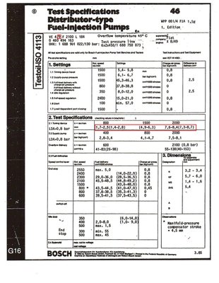

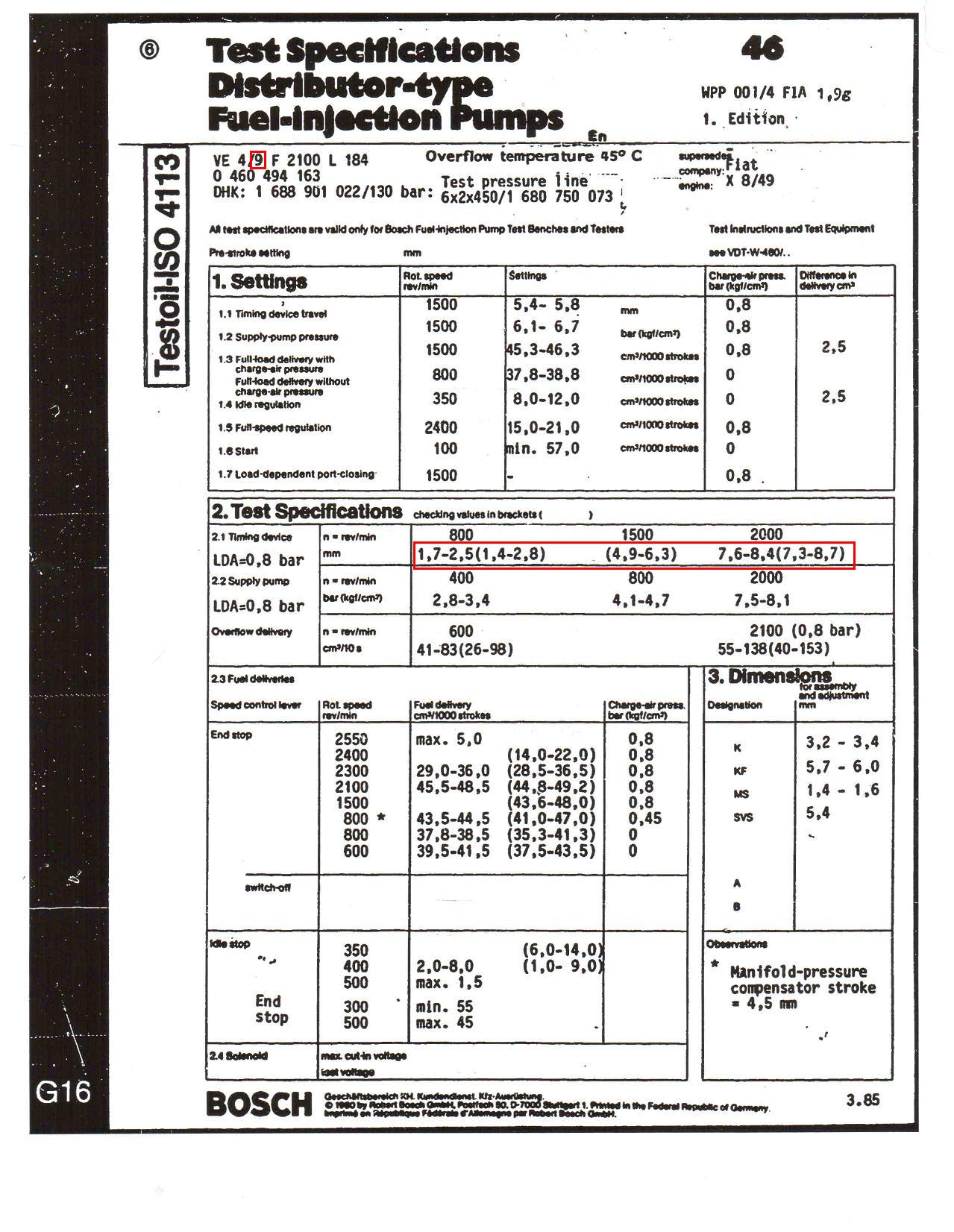

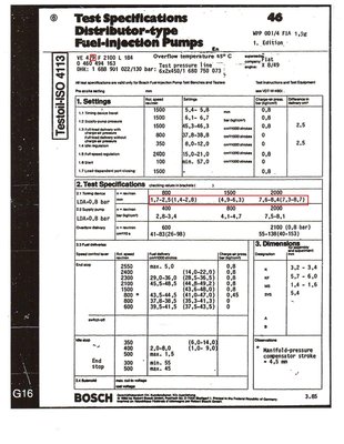

I consulted with a specialist in fuel systems.
Test plan for injection pump 0 460 494 163 on attachment.
It not an absolutely successful choice on characteristics.
Diameter plunger = 9 mm. It is small for 3,1L.
The very large course of the timer of an advancing, is possible(probable) will be overheating the engine on the high rotations, because of the large size of a corner of an advancing.
Probably in winter I shall give the injection pump from my 243 for auditing and for him will be made test plan of a similar kind. Now, on it IP, diameter plunger = 10 mm. Probably (if there will be necessary to replacement because of wear and deteriorations) plunger will be replaced on 11mm.
