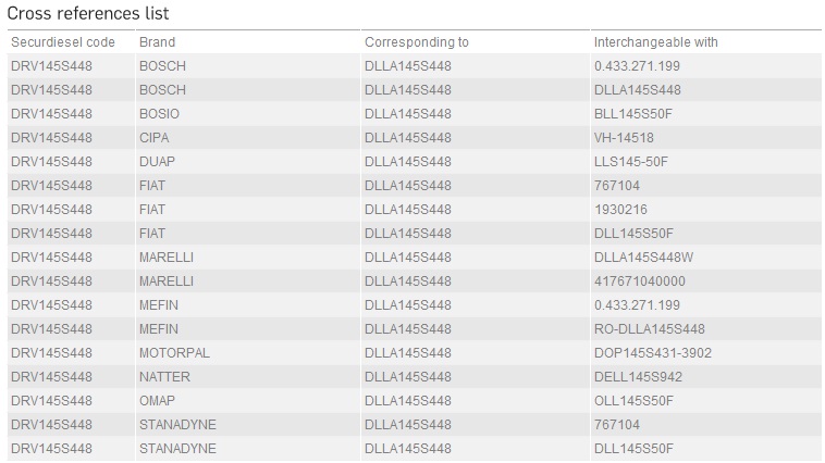

Din cate stiu eu, se pot schimba diuzele la injectoarele de Brasov cu unele Bosch. Stie cineva ceva mai exact ?
 Post subject: Re: Alte injectoare pe D127
PostPosted: Mon Jul 11, 2011 6:22 pm
BOSCH number - 0433271199.
This is a very expensive nozzle. :shock:
There are some analogues.
The most optimal in price / quality ratio - German DTP11199.
Good quality at MEFIN / HIDROJET - DLLA 145 S 448. :D :ugeek:
The remaining rooms analogues able to say later.

Pulverizator prod. Italia SECURDIESEL DRV145S448
PostPosted: Mon Feb 13, 2012 9:57 am
Cam la ce pret se gasesc aceste diuze in Moldova ?
Corespondente:
