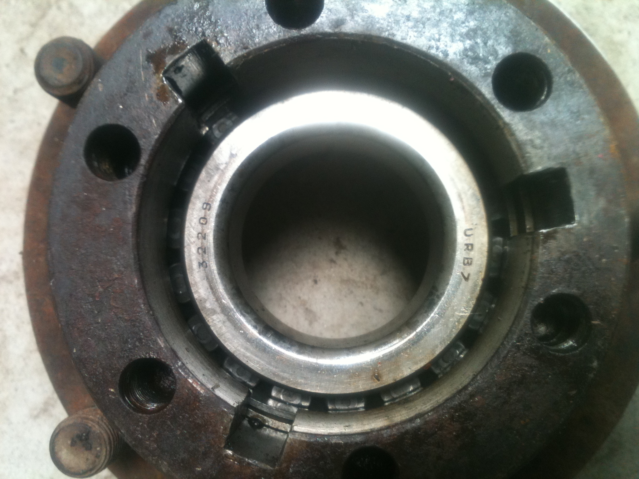

PostPosted: Sat Jul 30, 2011 7:33 am
Rulment Butuc IMS/TV
32209 - 2 bucati/butuc
