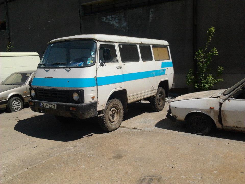

PostPosted: Mon Apr 23, 2012 11:04 am
Ultima si cea mai recenta ipostaza... Asteptand Festivalul de Mecanica.
380318_261134490649579_100002590916478_511835_2021020577_n.jpg [ 92.64 KiB | Viewed 7468 times ]
PostPosted: Mon Apr 23, 2012 4:13 pm
Posts: 54
Location: Iasi
and waiting...and waiting...and waiting........... and waiting :))
PostPosted: Mon Apr 23, 2012 7:50 pm
Nu mai lasa minunatia langa Dacie, nici nu stii cum se imbolnaveste de ruginita
