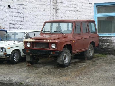

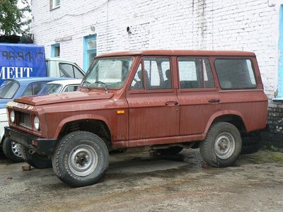

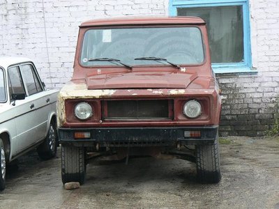

244, 1991 year, powered BRASOV D127005, 4st gearbox, full drums brake system.
Run, now, approximately unknow km.
Living - deep north: settlement 80%, the north village 20%, all - middle and hard offroad.
Almost all her life it in settlement Vanavara and Baykit city, such on north-east Krasnoyarsk area (Evenkija - Tunguska river - Baykit city and Vanavara settlement)
Near Vanavara has taken place Tunguska Explosion (Tunguska Paradox). It sole ARO, what was so close to this mysterious and remote place...
In 2005 it ARO a return on the "big ground", in Bolshaya Murta village (in 100 km from Krasnoyarsk)
In 2007 I'm has bought this ARO...
Now - her in restoration stage...
In photos - such her has come from village after bought...

The body looks very nice, apart from the right fender, but otherwise nice!
You're missing the front grill, what will you be using?
