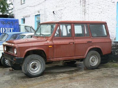

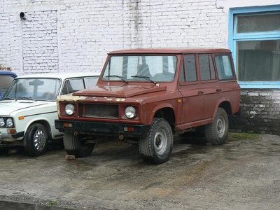

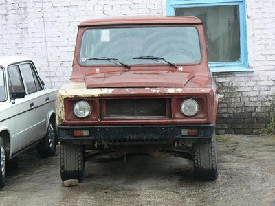

244, 1991 year, powered BRASOV D127005, 4st gearbox, full drums brake system.
Run, now, approximately unknow km.
Living - deep north: settlement 80%, the north village 20%, all - middle and hard offroad.
Almost all her life it in settlement Vanavara and Baykit city, such on north-east Krasnoyarsk area (Evenkija - Tunguska river - Baykit city and Vanavara settlement)
Near Vanavara has taken place Tunguska Explosion (Tunguska Paradox). It sole ARO, what was so close to this mysterious and remote place...
In 2005 it ARO a return on the "big ground", in Bolshaya Murta village (in 100 km from Krasnoyarsk)
In 2007 I'm has bought this ARO...
Now - her in restoration stage...
In photos - such her has come from village after bought...

PostPosted: Sun Nov 15, 2009 6:11 pm
The body looks very nice, apart from the right fender, but otherwise nice!
You're missing the front grill, what will you be using?

Maxim, post pictures of the restoration process, like I did! Have you seen my work on the 243? It's not ready yet, and a lot of very good friends have helped me.
PostPosted: Sun Nov 15, 2009 7:07 pm
I'm will write about every parts of restoration, especially giving attention on " problem places ". Also concerning changes of a design of some elements.
...with little help of my friends... gold words, that said THE BEATLES

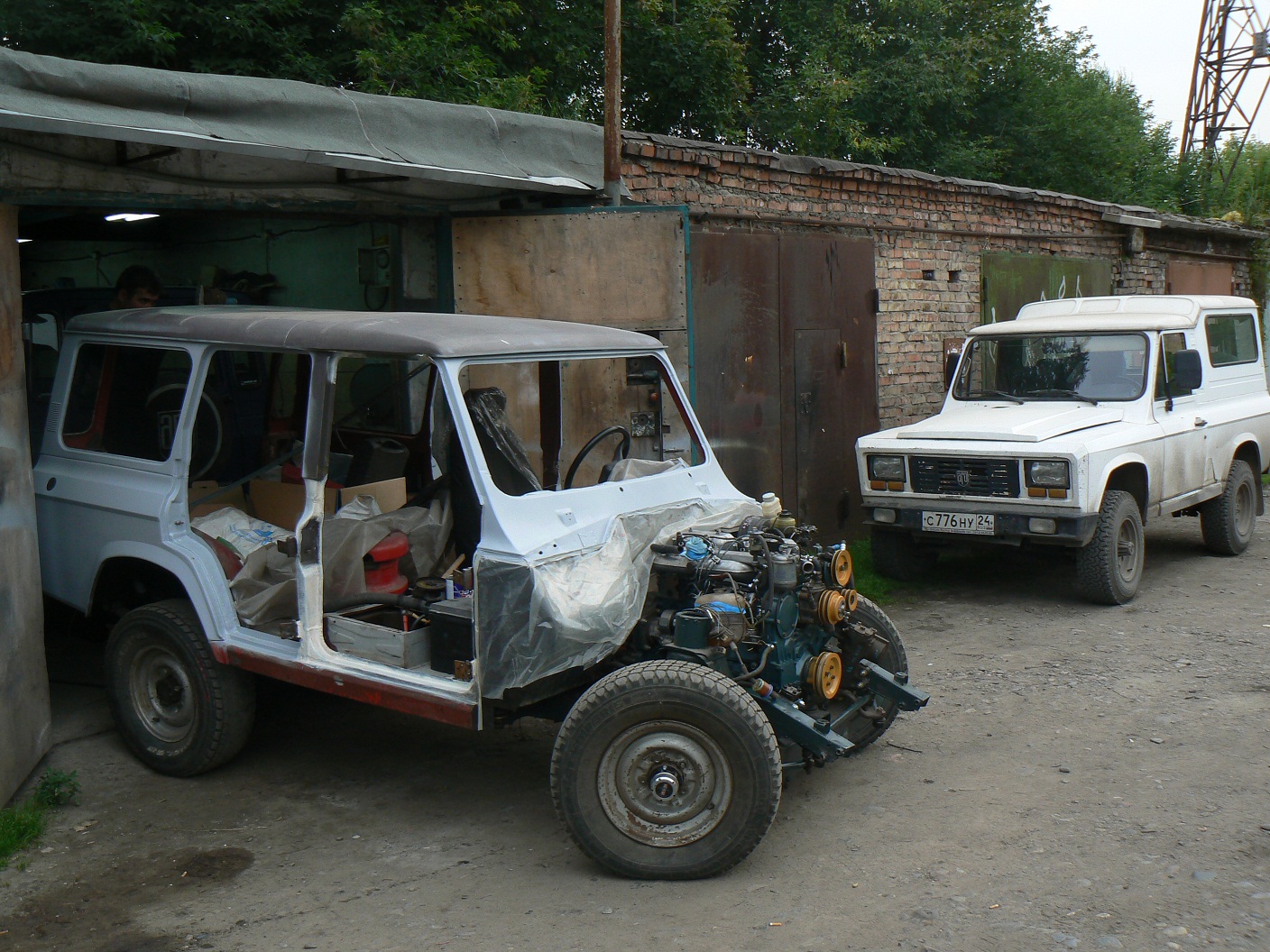

PostPosted: Sat Jun 25, 2011 6:42 pm
Nearly completed body works. :)
Priming and painting has begun! ;)
I did start the engine after full repair. Works great! :D

PostPosted: Fri Jul 22, 2011 6:10 pm
...it the next stage of recovery... ;)

PostPosted: Tue Jul 26, 2011 8:02 am
Here's the video of the first drive, from Maxim!
http://www.youtube.com/watch?v=OnNw4i7RZcg
My observations:
- no power steering :D
- the "air filter" (actually piece of cloth) choked the engine a bit
- custom fuel pump?
- custom engine stop device?
- custom springs - but they are too small and thin, and the front sits very low (even without the fenders and hood). I would change these, try something else, perhaps the originals!
- custom clutch pump? But the clutch isn't yet working great.
