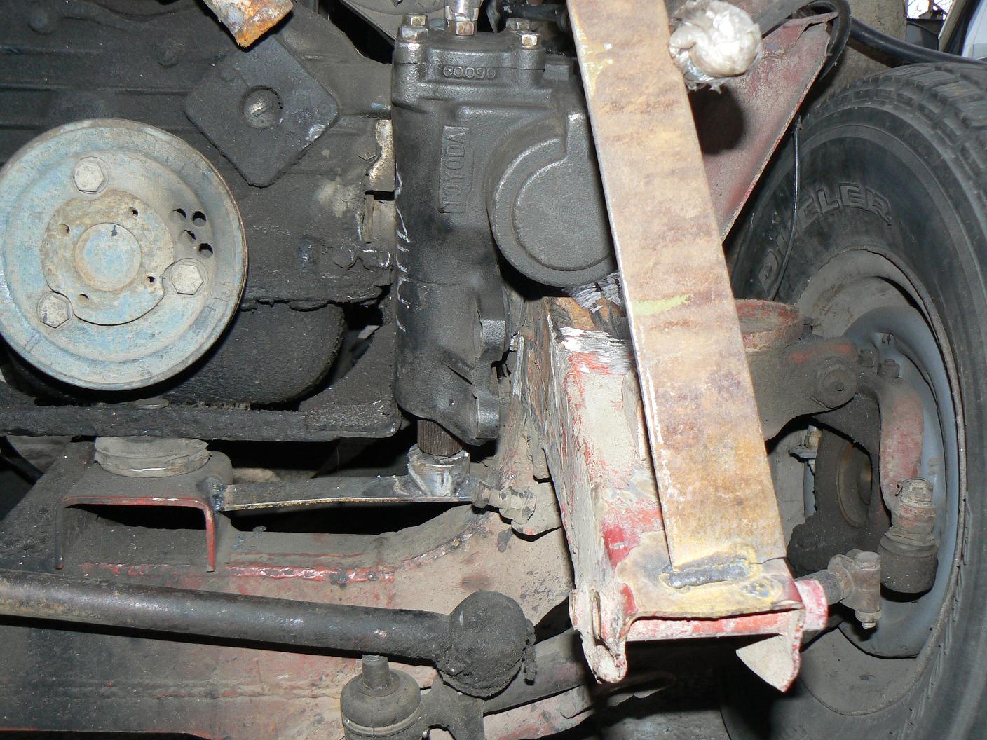

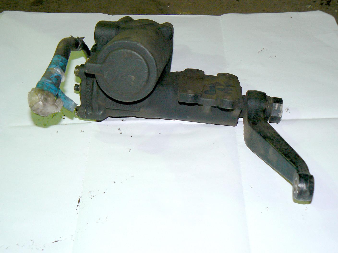

1 - Was formed the axle disposition "native steering". It fitting will visible on drawings. For it: - remove nut from the ended shaft and make the low support; - on the adjustment screw a fit the rod with carving, one side as ARO, other side as on new steering.
Such a make correctly the placement steering on the frame...

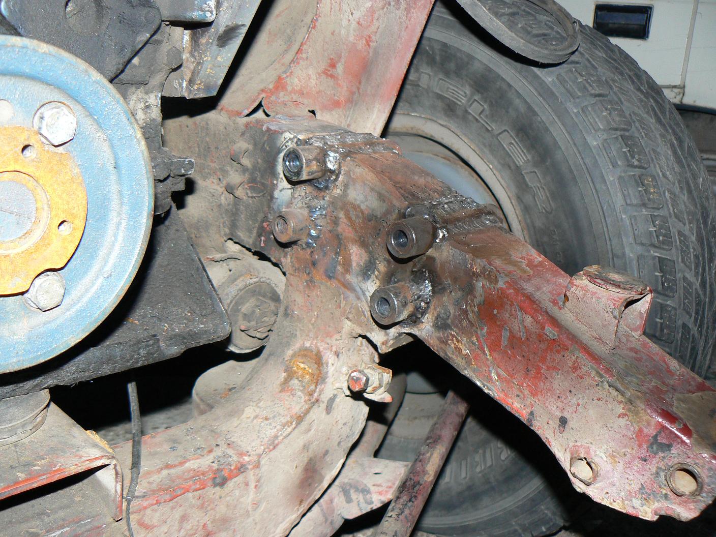

Futher - from the frame was removed body and engine, for the work for restoration of the frame...
