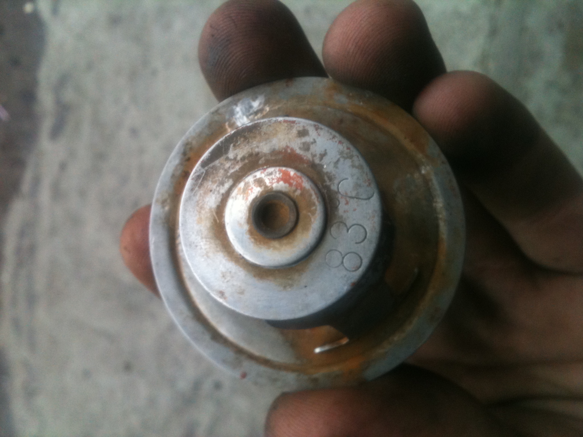

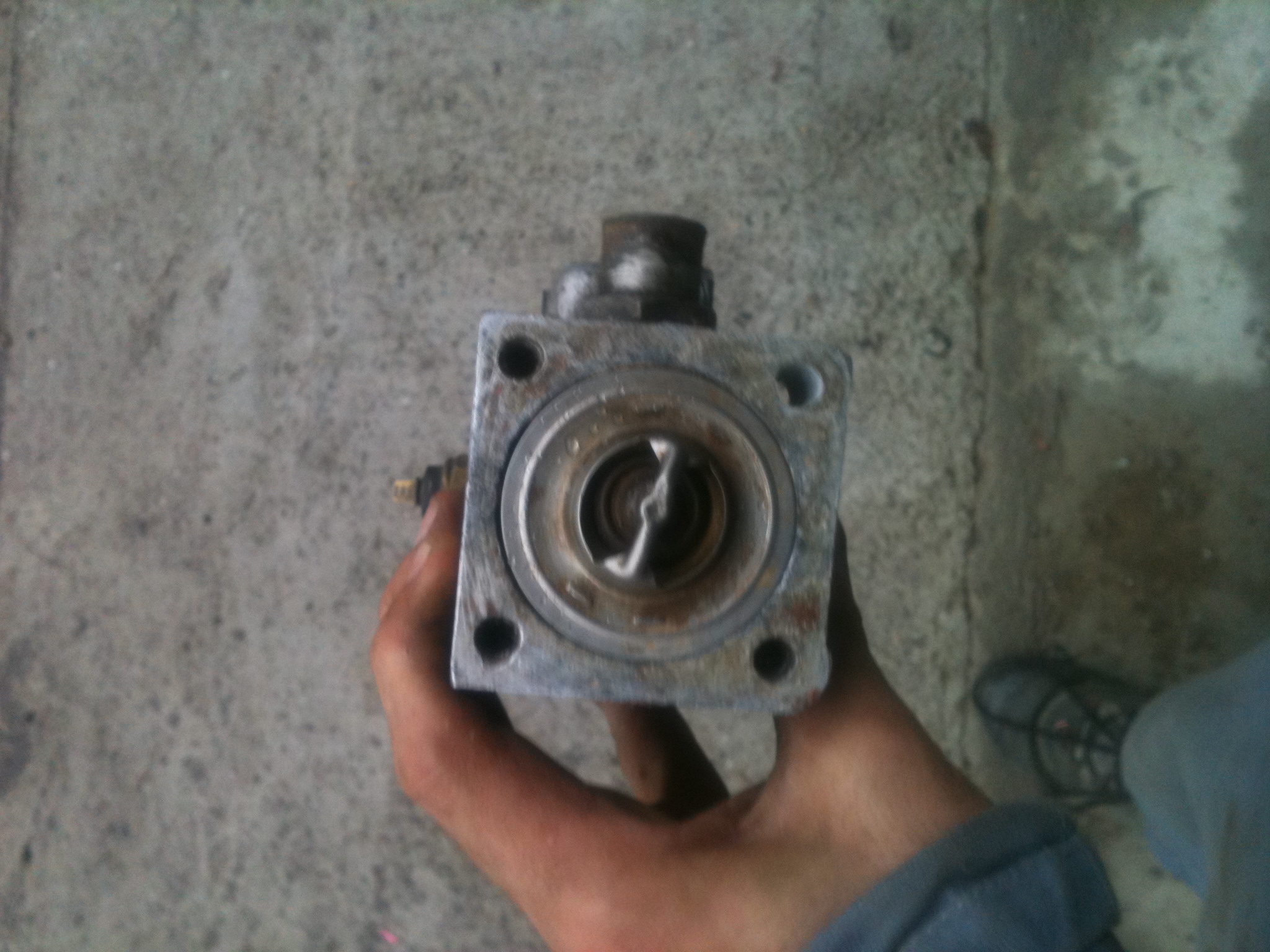

Poze cu termostatul si cu sondele de apa

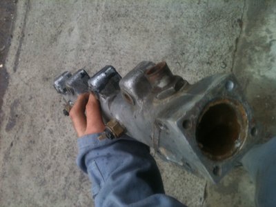

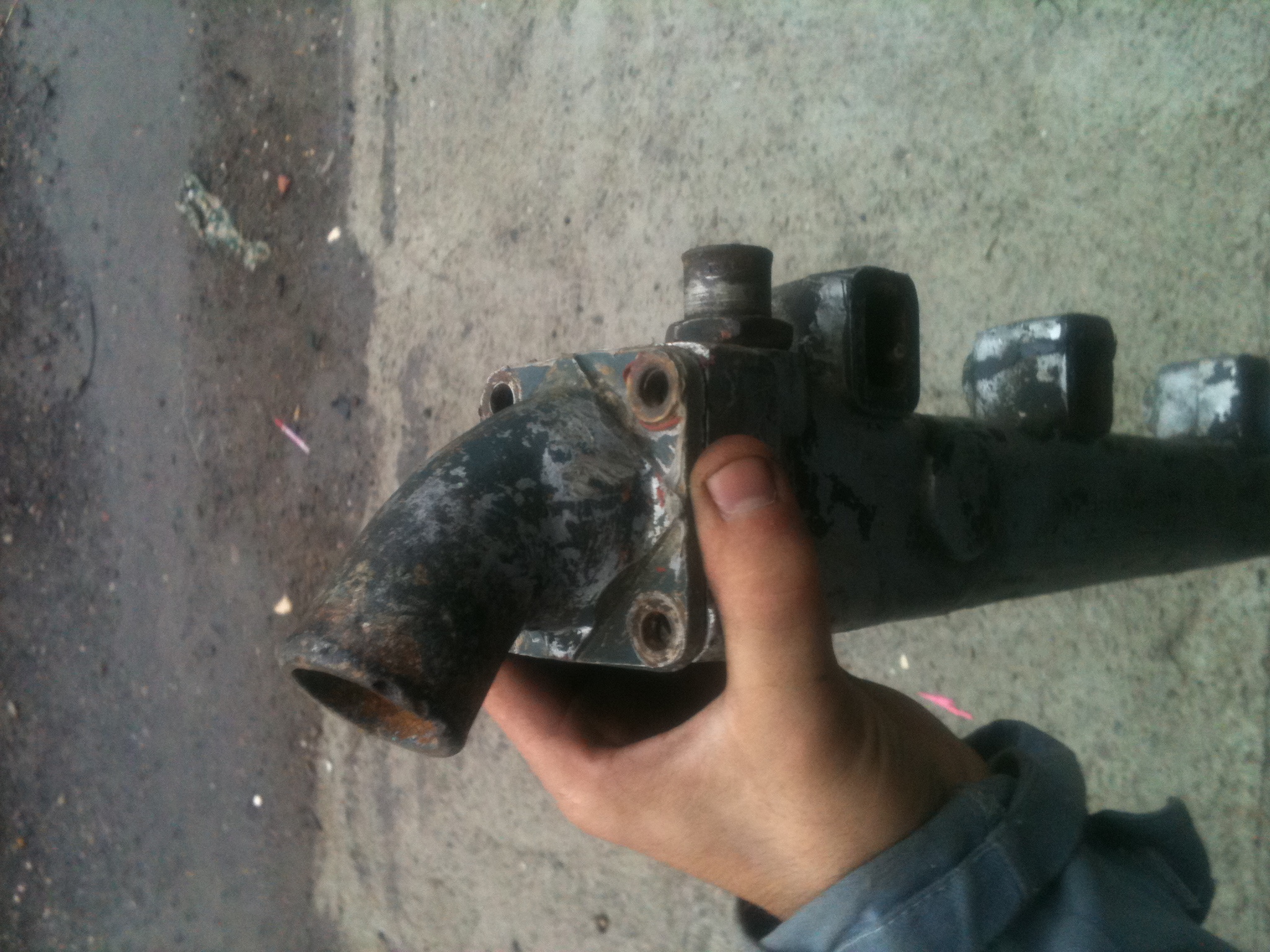

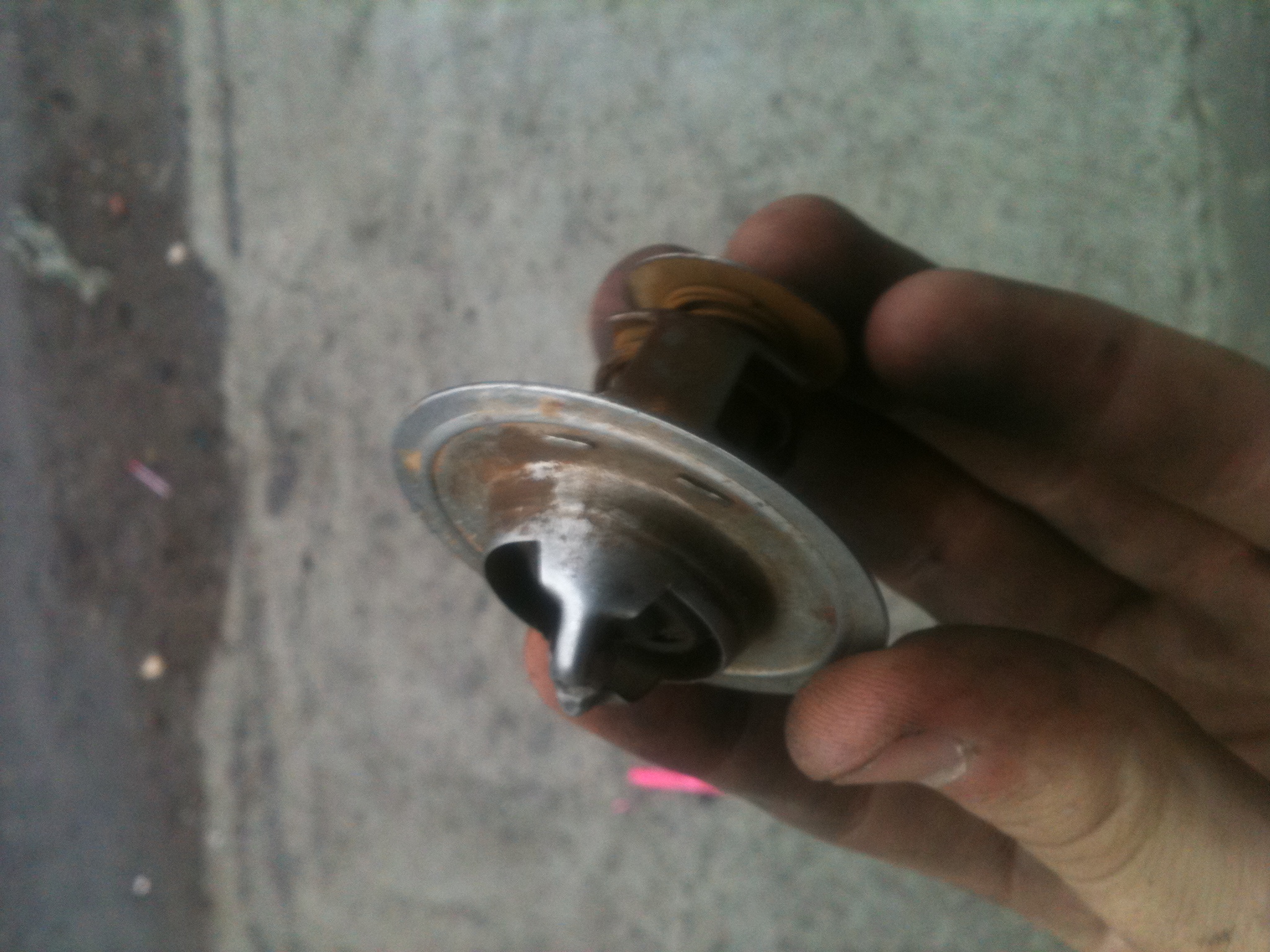

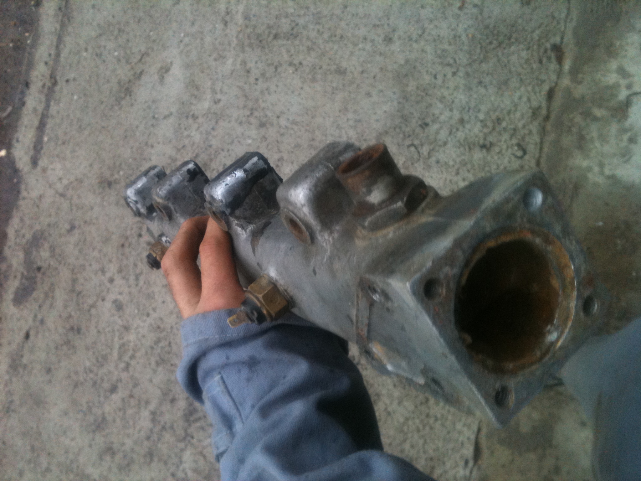

Fluierul de apa si pozitia termostatului

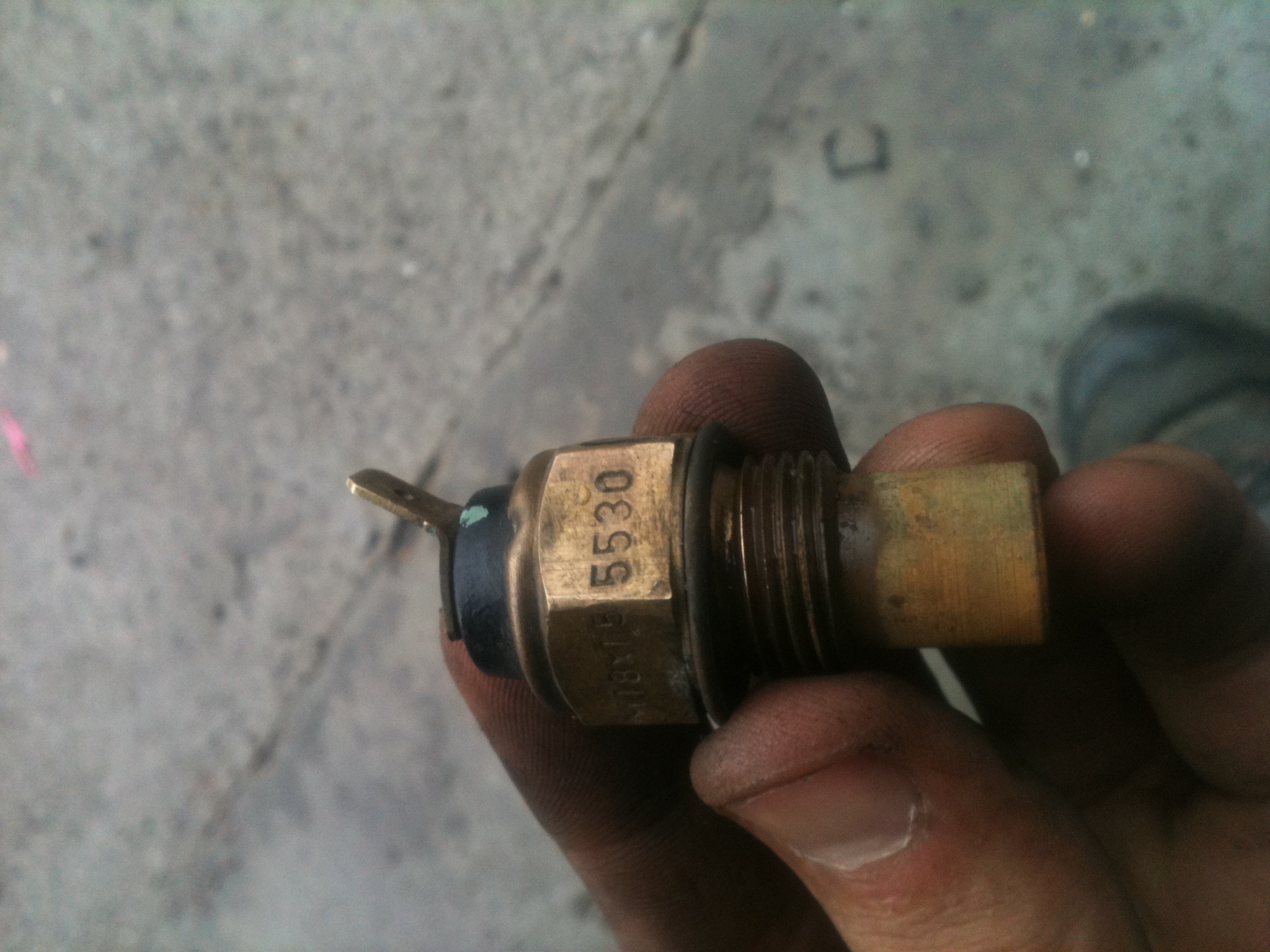

Sonda pentru becul de fierbere a apei - 5530 si e marcat cu 120 grade C

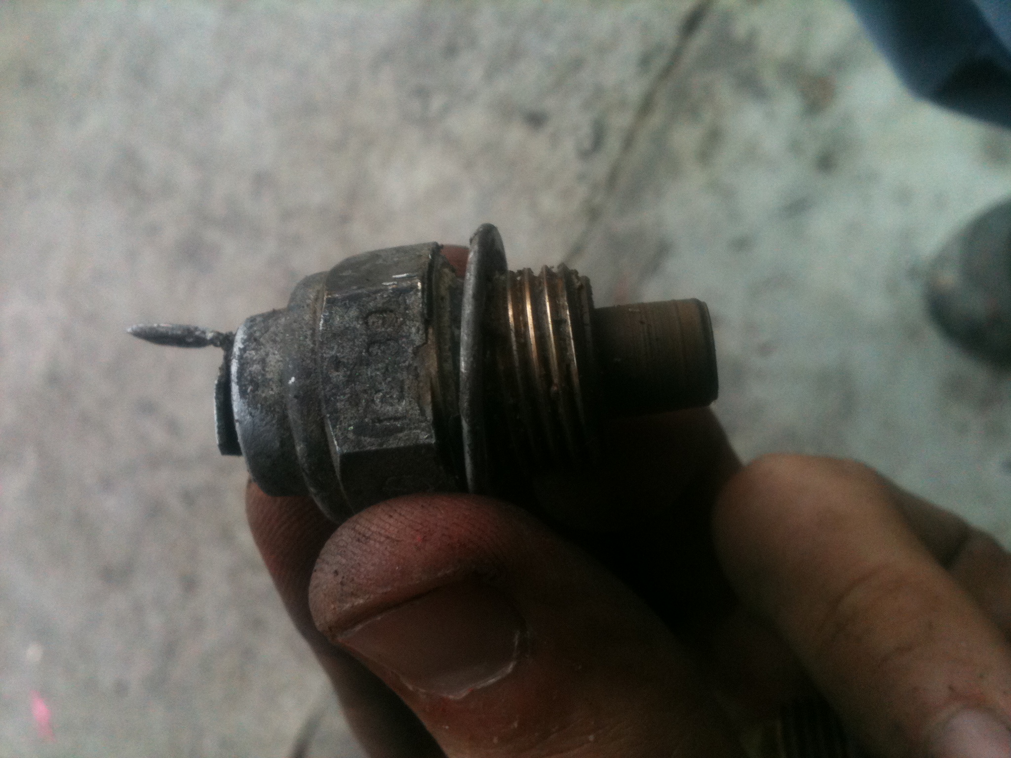

Sonda pentru indicarea temperaturii - are cilindrul care sta in apa mai mic
File comment: sonda temperatura
File comment: sonda bec

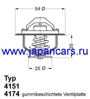

thermostat analog:
WAHLER 4174.82D
FIAT 5 0032 9622
IVECO 50 032 9622
PEUGEOT 1338 90
Gates TH22782G1
Valeo 820 432
Febi 21003
Triscan 8620 5488
SWAG 62 92 1003
Facet 7.8314
Facet 7.8677
Quinton Hazell QTH558
Vernet 6581.82/J
HL Group Oy 500-120482
Behr B.346.83
Valeo 820 432

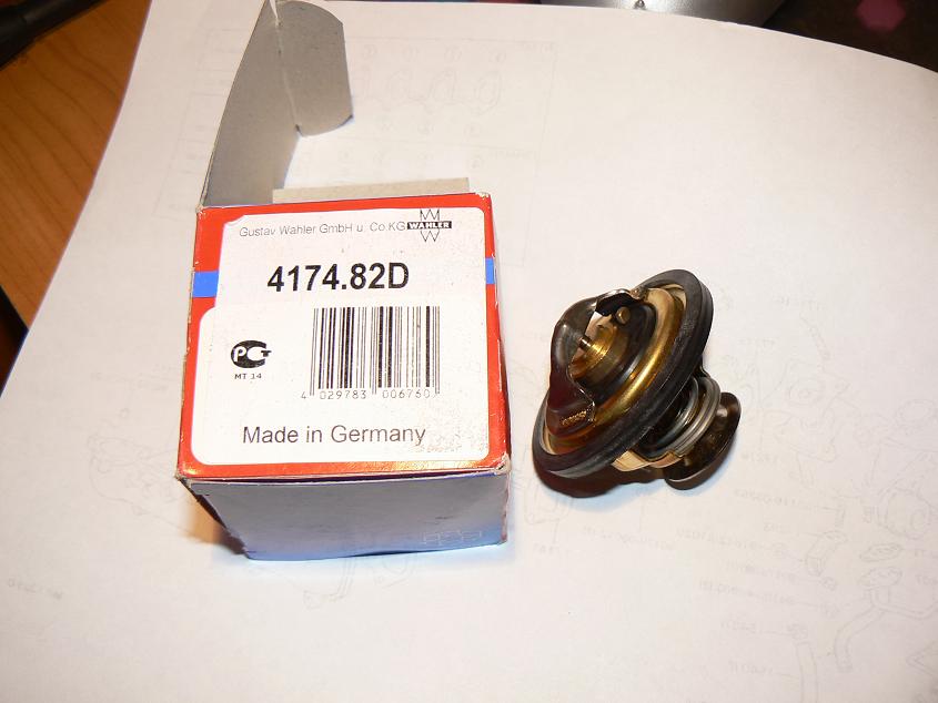

Hi Stef!
Yes. I'm fitting WAHLER 4174.82D on my 244.
All other - analogue for it.
p.s. analogue for temp sensor - not found :(

Following Maxim's example - I ordered :
http://www.autoeco.ro/piese-auto/FIAT/D ... t-1625833/
WAHLER = 45 RON (VAT included)
Opening temperature = 82 deg Celsius - which I find to be a very good temperature for BV, compared to the Romanian variants of 83 / 85 deg.
