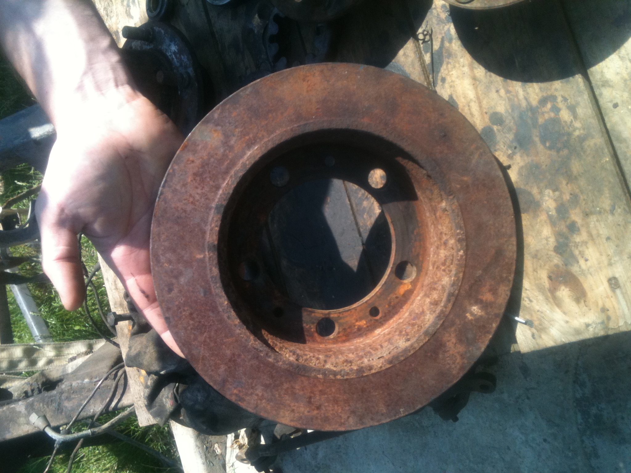

PostPosted: Mon Jul 11, 2011 11:19 pm
Cel din poza are 20mm, probabil cel masurat de tine are un pic de uzura
