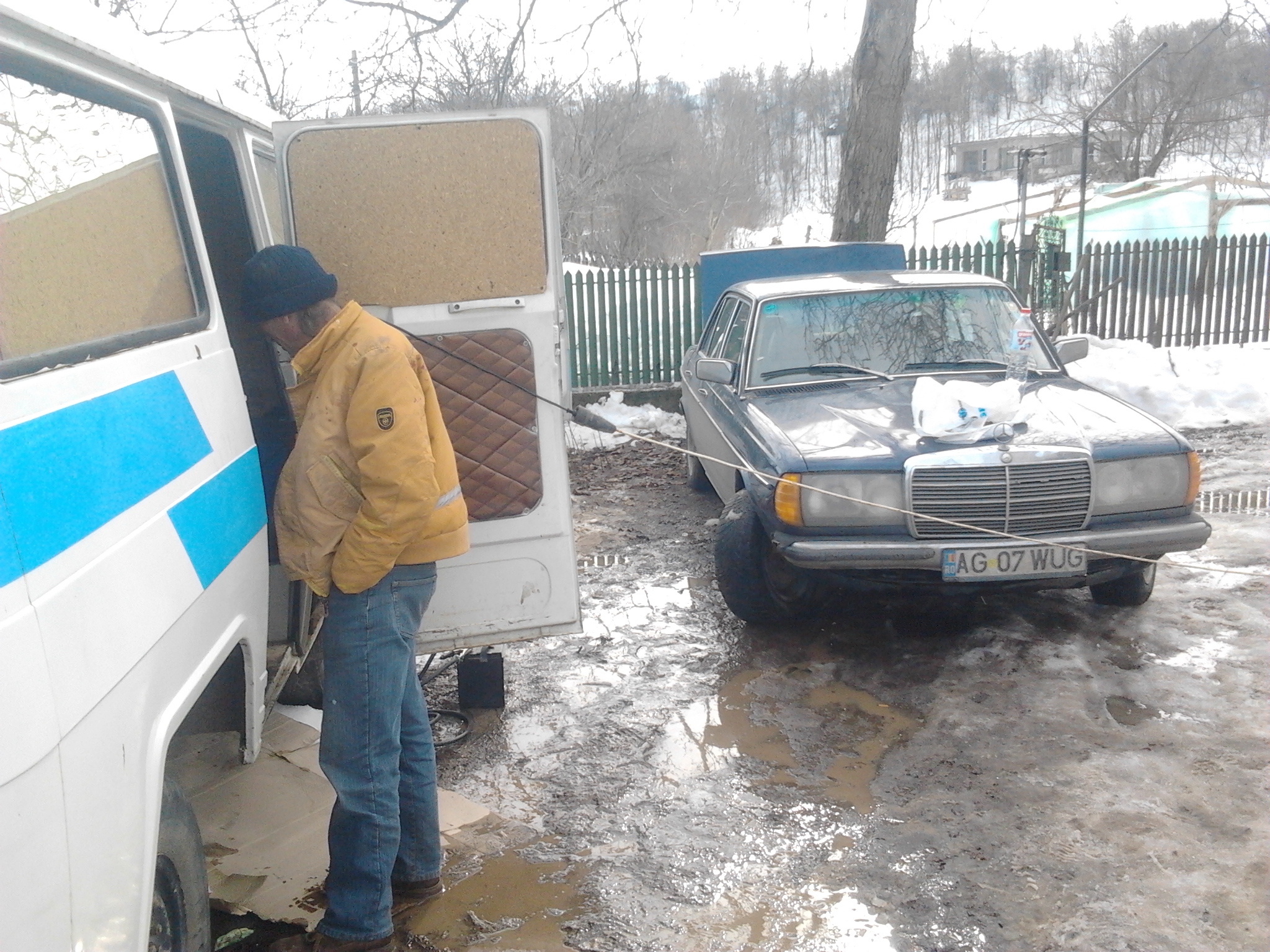

PostPosted: Tue Feb 28, 2012 1:37 pm
Operatiunea de Duminica...
