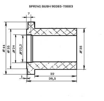

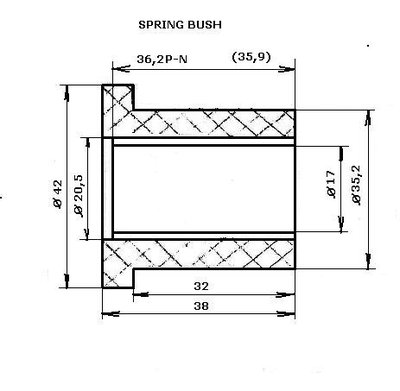

Bladespring bushing - almost full analog:
TOYOTA __ 90385-T0003, 90385-T0008 - front end of rear blade spring from TOYOTA HILUX 2005-2010 (body GGN15,25,35,KUN1#,2#,3#,LAN15,25,35,TGN1#,26,36);
analog for this:
RBI ______ T20VG02F;
Febest ____ TSB-822.
The required finalization - new steel the distance bushing
O 17 X O 22,5 X 36.
Quality RBI more good, than Febest, and, very low cost.
