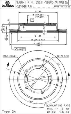

measurements

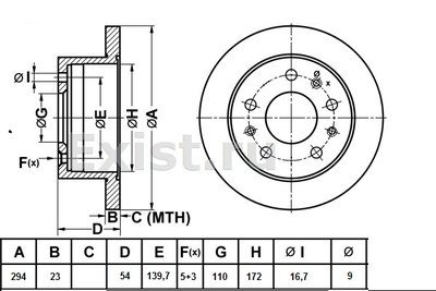

...If it interesting for someone...

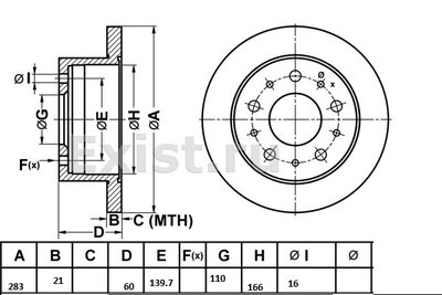

De discul asta de vitara ventilat ce ziceti?
e6494b0d-0549-44e6-8b64-2ab686b4cfb8V1-1000F1000.jpg [ 95.35 KiB | Viewed 67282 times ]
