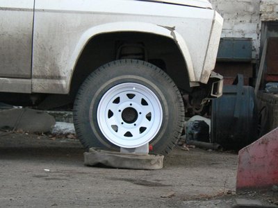

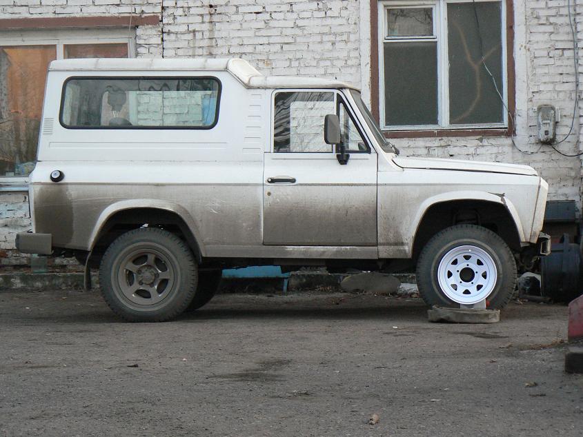

For my ARO 244 bought .
Will be tyres BFG All-Terrain 30x9,5x15.

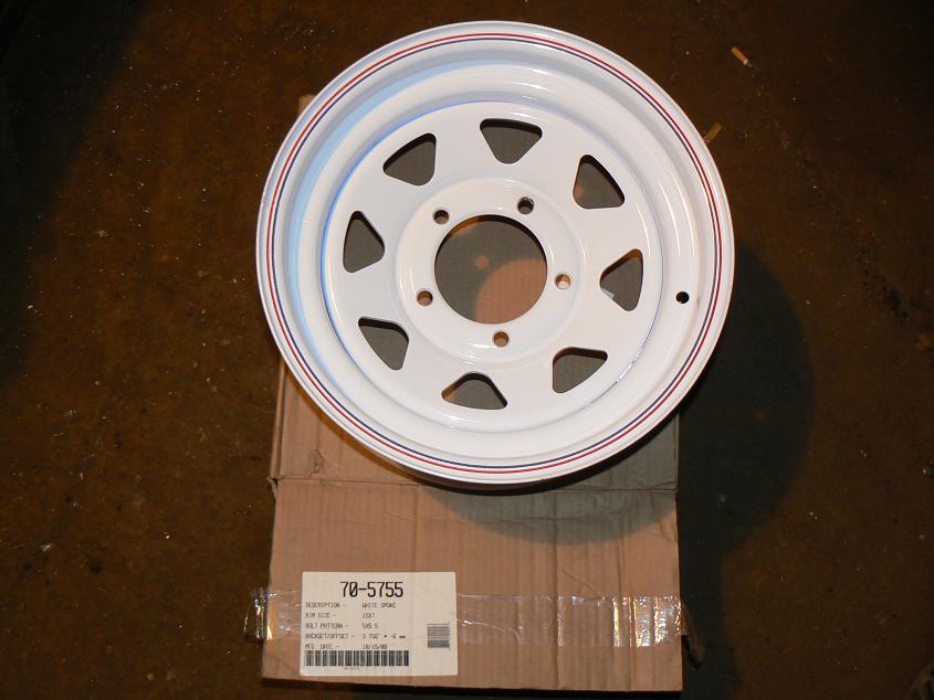

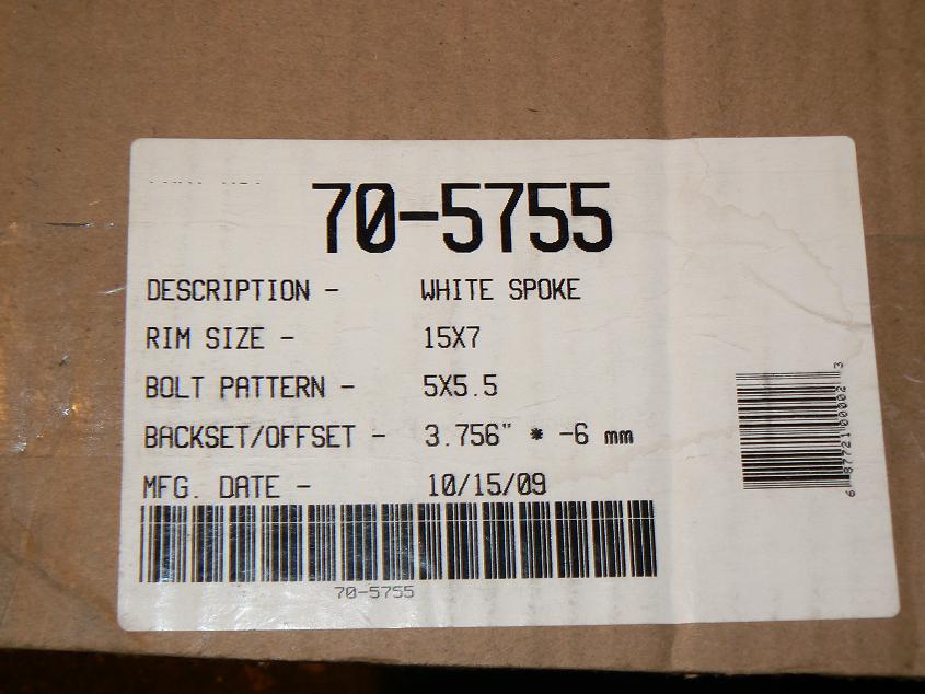

...fitting...

For the original 15" Spoke wheels: 15x7" ET +5
The rims you bought, are perfect with 30" tires, the difference in ET (11mm) is usefull when using snow chains.
