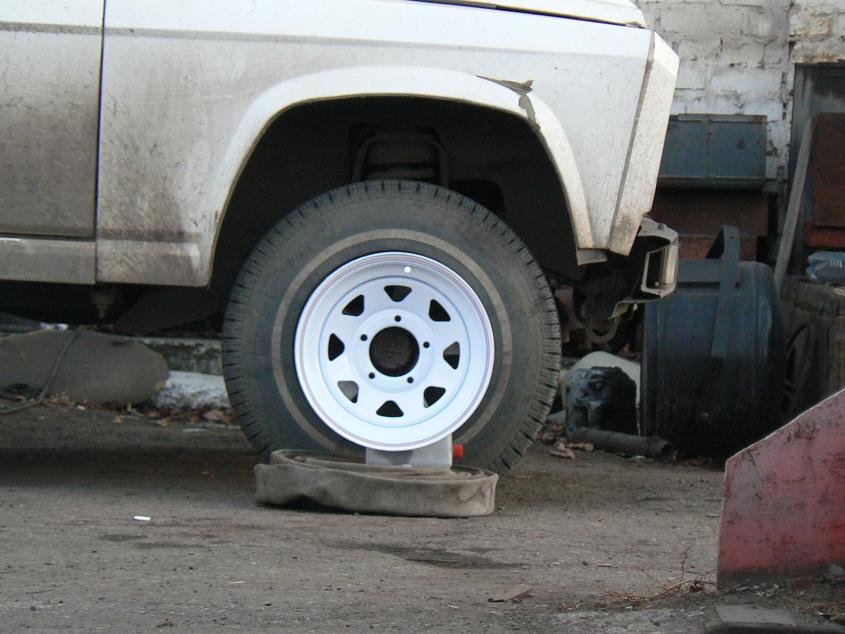

For my ARO 244 bought .
Will be tyres BFG All-Terrain 30x9,5x15.

...fitting...

What parameters of rims ARO 15'?
Example: for 16' - 4,50x16 ET+20
 Post subject: Re: roata si anvelope(rims and tyres)
PostPosted: Thu Nov 11, 2010 8:01 pm
For the original 15" Spoke wheels: 15x7" ET +5
The rims you bought, are perfect with 30" tires, the difference in ET (11mm) is usefull when using snow chains.
