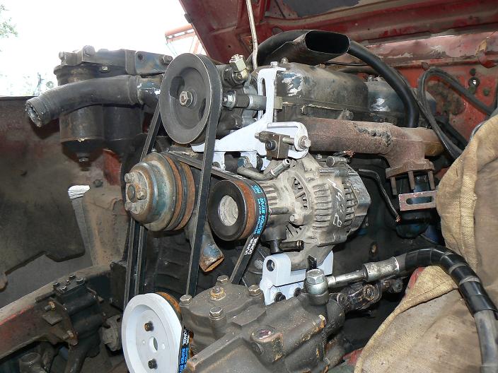

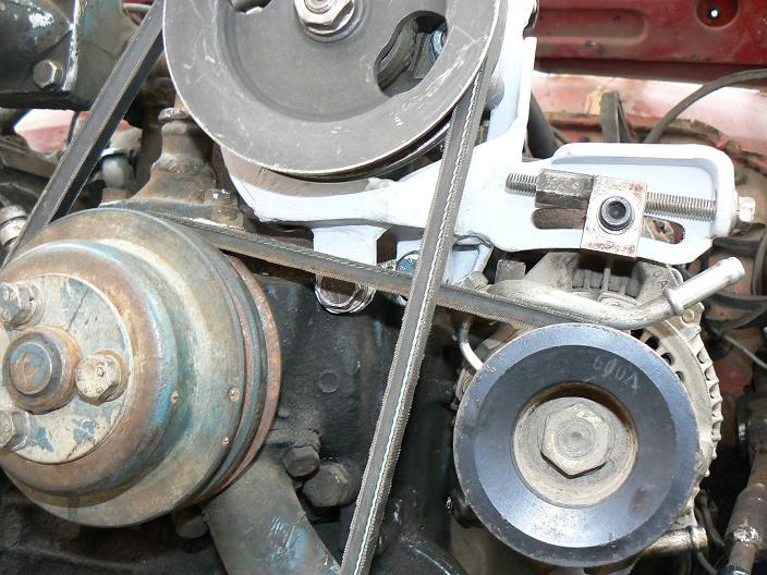

In time of the fitting servodirection was fitted
also servodirection pump and the generator unit.
As it - visible on the photos
Pump - from TOYOTA, type, what having three connecting holes.
High pressure pipe a I'm will do by self.
