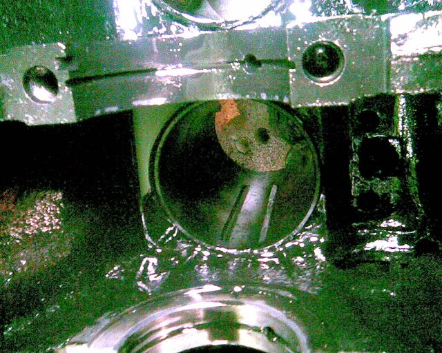

... The auditing of the engine has come. There was a hope (very weak), that will be enough a washing and installation of new gaskets...
Has taken off the oil bath. The oil in him was similar jelly (at +10C'), and at washing the unpleasant gift was found. Fragment of snap ring. Using small lamp I discovered damaging of third cylinder. All became clear. Illness of the motor BRASOV. Full repair of engine...
... It illness was touched approx 50% of engines ( plant numbers 115XXX - 118XXX, from those that i visible).
- Piston pin do depress of snap ring;
- fragments of ring, and then itself pin do damages of the cylinder liner.
It was reasons:
- Became to black oil fast.
- Motor very much "sweated" by oil.
- The oil is strong "oxidized" and converting in jelly...
Practically, it problem, always in second or third cylinder.
Further - order, waiting of spare parts. After receiving parts - disassembling, washing and checking of engine parts...
Other damages also was found...
