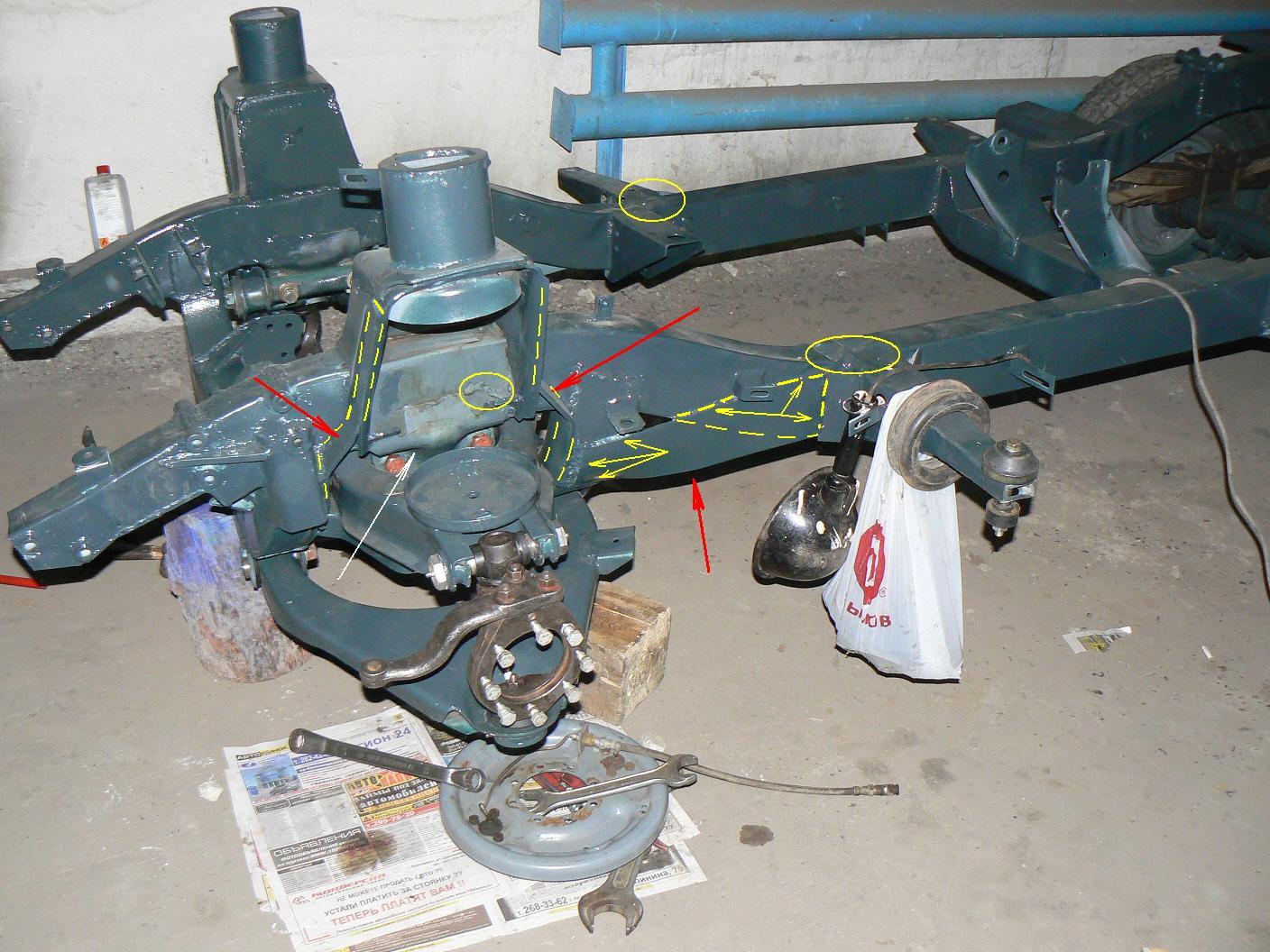

My works about frame on fig.:
yellow lines - the welded seams;
yellow circles - forced overlays;
red - forced elements.
