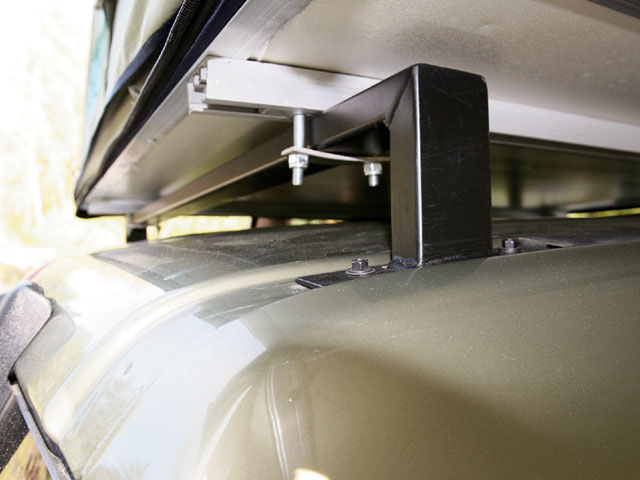

PostPosted: Mon Nov 02, 2009 7:07 pm
Cort de la ARB asa ca idee :idea:
0709_4wd_02_z+arb_simpson_ii_tent+jeep_liberty+rack.jpg [ 46.63 KiB | Viewed 9915 times ]
0709_4wd_17_z+arb_simpson_ii_tent+jeep_liberty+installed.jpg [ 121.38 KiB | Viewed 9915 times ]
0709_4wd_01_z+arb_simpson_ii_tent+jeep_liberty+front.jpg [ 144.67 KiB | Viewed 9915 times ]
