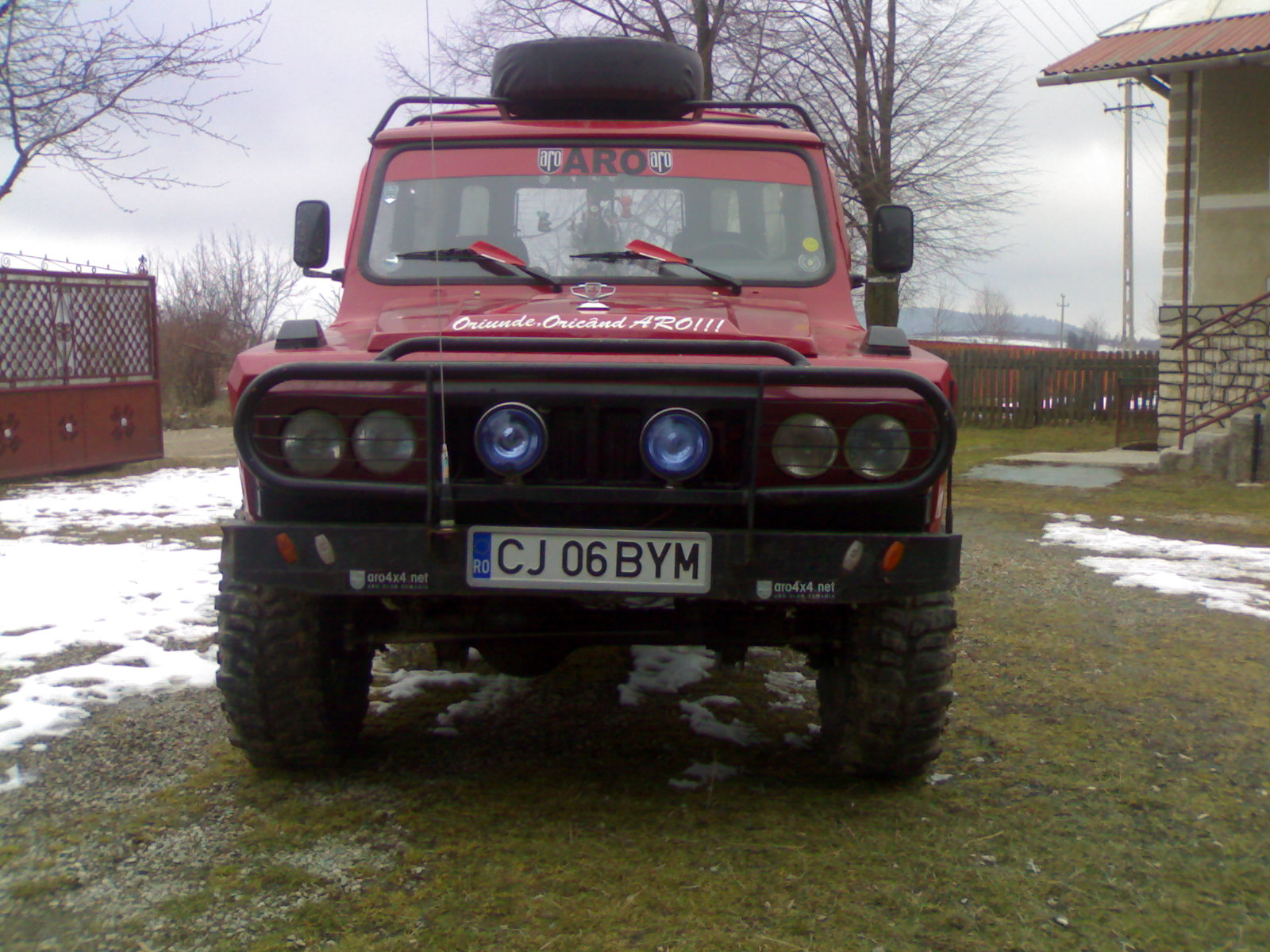

si in sfarsit maisna e gata cam 98 %.

8-)

What size wheels and tires?
 Post subject: Re: aro 243
PostPosted: Tue Feb 19, 2013 8:27 pm
31x10,5x15.8j,et -25 15
