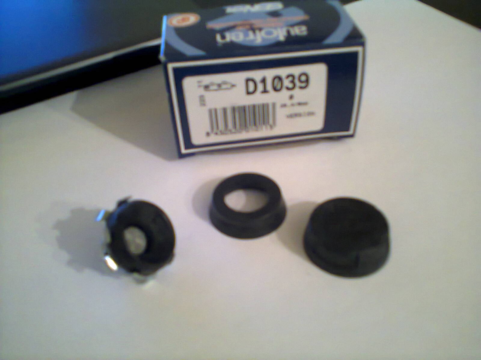

PostPosted: Mon Mar 25, 2013 1:21 pm
Set reparatie pompa frana (simplu circuit) / pompa ambreiaj ARO 240-244, AUTOFREN SEINSA D1039
Producator: AUTOFREN SEINSA
Cod producator: D1039
Diametru [mm]: 25,4
Pret: 22 RON.
