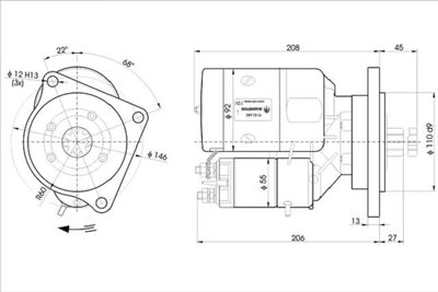

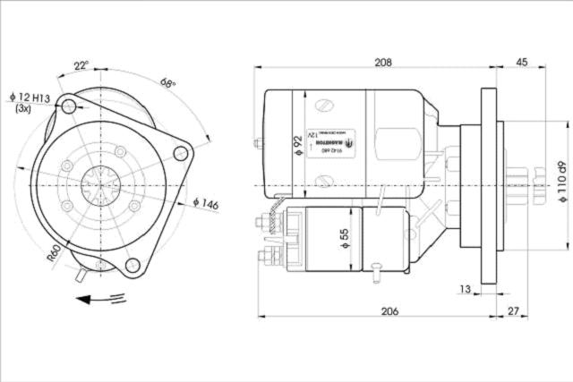

A list of compatible starters for D127 and what have a price tag of more-less adequate:
ATS:
ATSCS 370 _________________________ 12/2,2 KW
ATSCS 510 _________________________ 12/2,2 KW
Avp:
SM30007 ___________________________ 12/3,0 KW
Cargo:
111996 ____________________________ 12/2,2 KW
110640 ____________________________ 12/3,0 KW
110522 ____________________________ 12/3,0 KW
110529 ____________________________ 12/3,0 KW
111693 ____________________________ 12/2,5 KW
113182 ____________________________ 12/3,0 KW
EAI:
11294 _____________________________ 12/3,0 KW
HC-parts
CS 230 _____________________________ 12/2,5 KW
CS 370 _____________________________ 12/2,2 KW
CS 510 _____________________________ 12/2,2 KW
CS 689 _____________________________ 12,2,5 KW
Delta Autotechnik:
A19320 ____________________________ 12/2,4 KW
LAUBER:
28.0240 ____________________________ 12/3,0 KW
WAI:
2-3125-2W _________________________ 12/2,2 KW
2-3173-2W _________________________ 12/2,2 KW
2-3309-2W _________________________ 12/2,2 KW
2-3109-2W _________________________ 12/3,0 KW
2-2325-BO _________________________ 12/ ? 2,7 KW ?
18029N ____________________________ 12/3,0 KW
50-9900 ____________________________ 12/3,0 KW
All of these are:
centering diameter - 110 mm, flight gear from the plane flange - 27 mm, number of teeth - 9.
To clarify - picture MAGNETON 9 142 680.
Cargo 110640 - full analogue of the native.

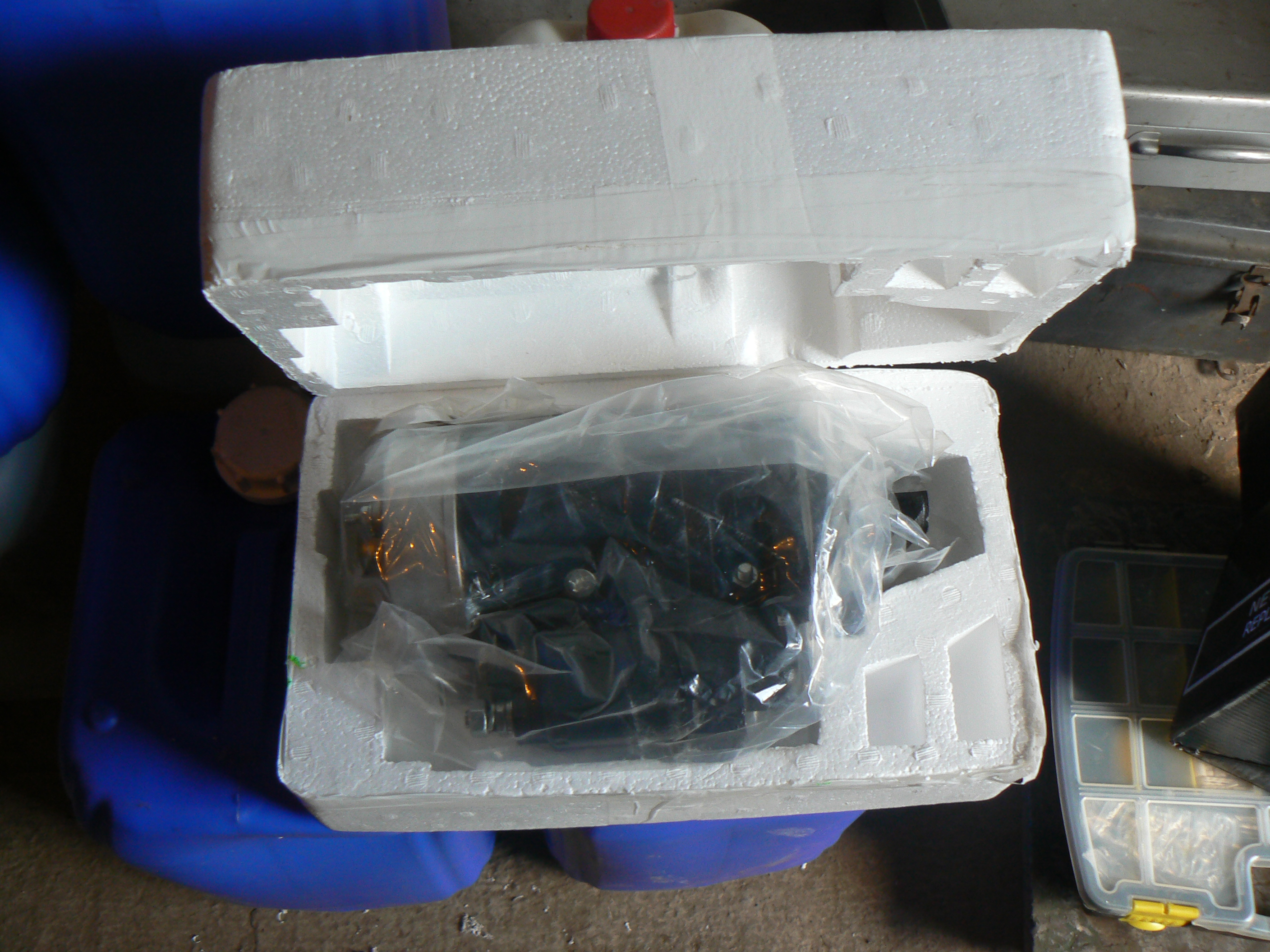

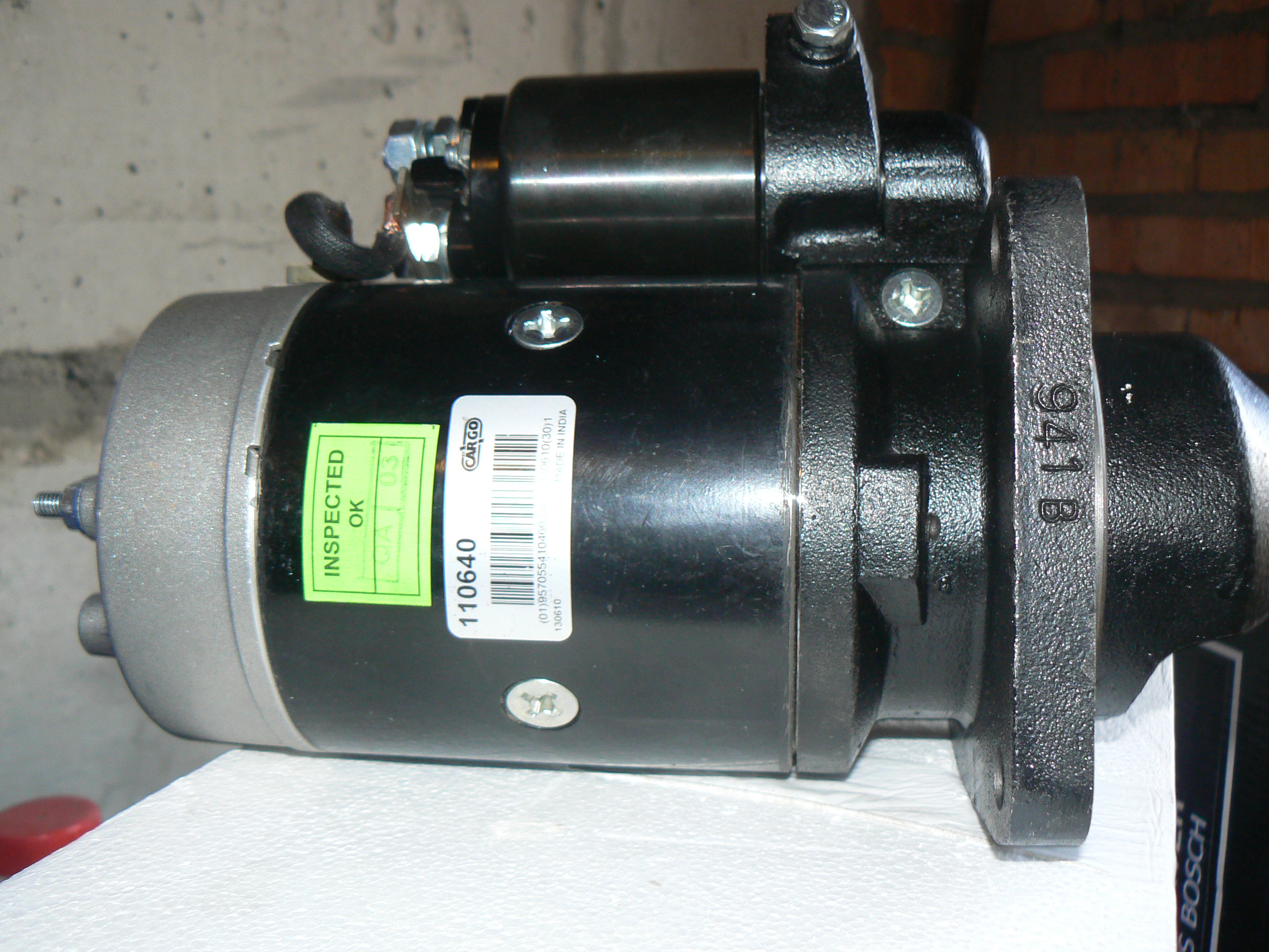

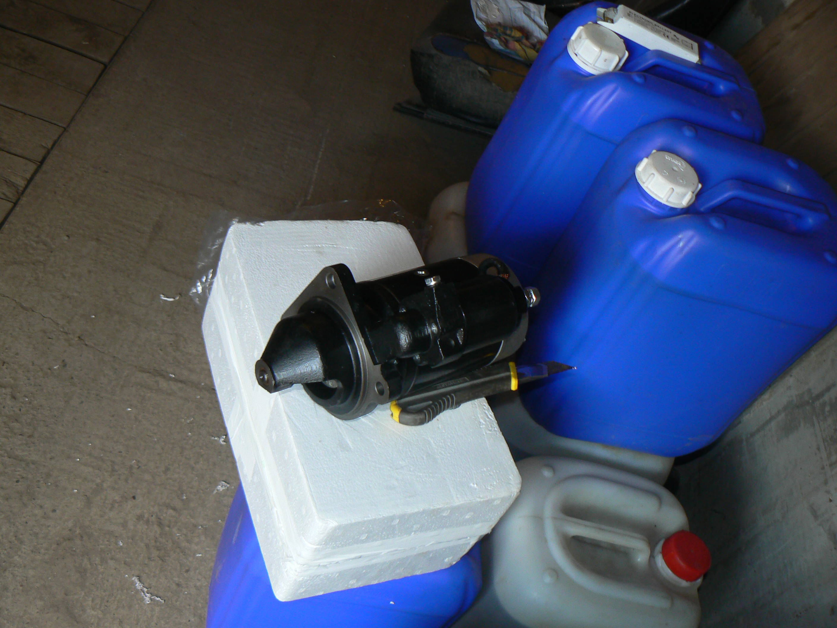

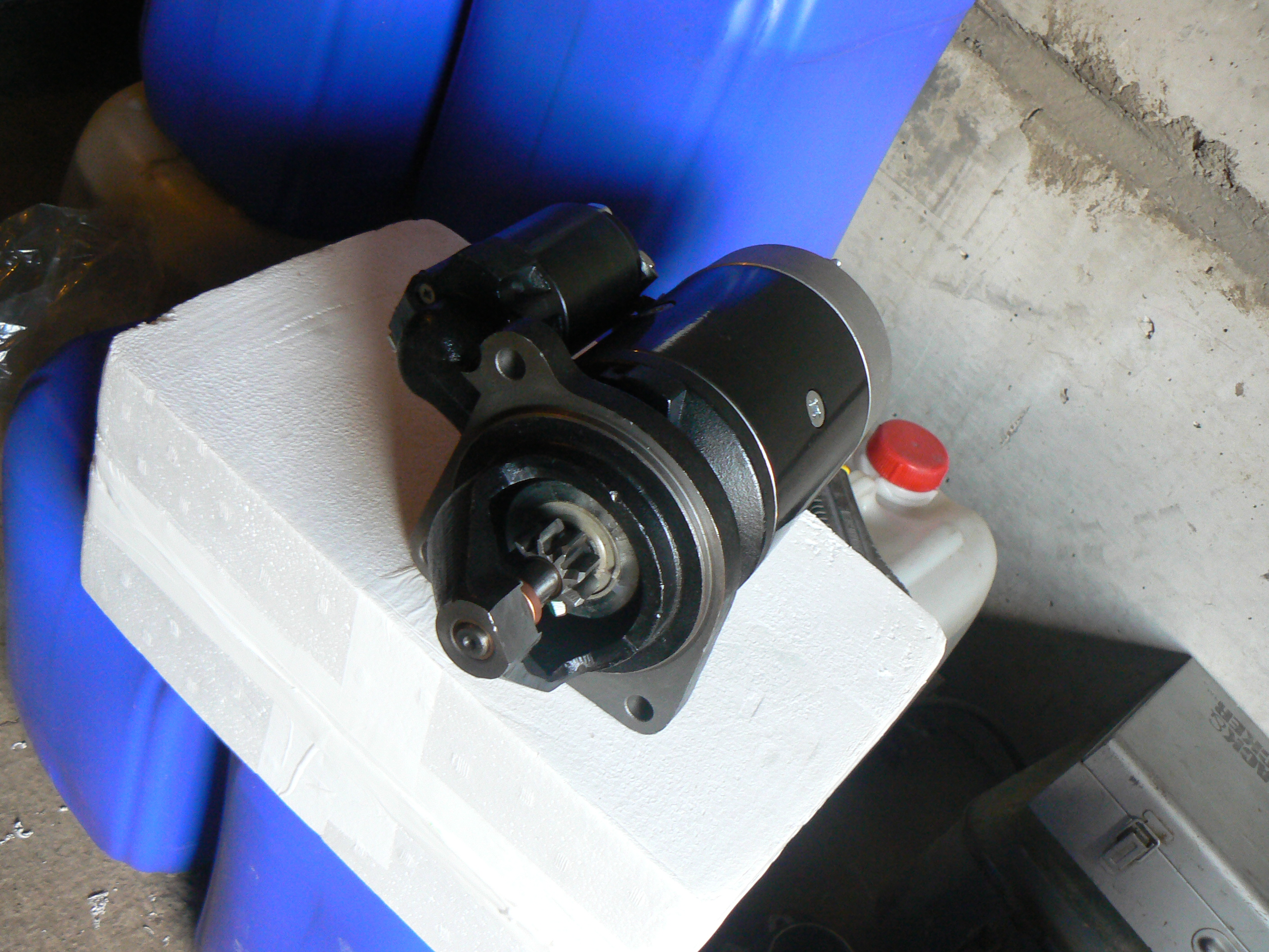

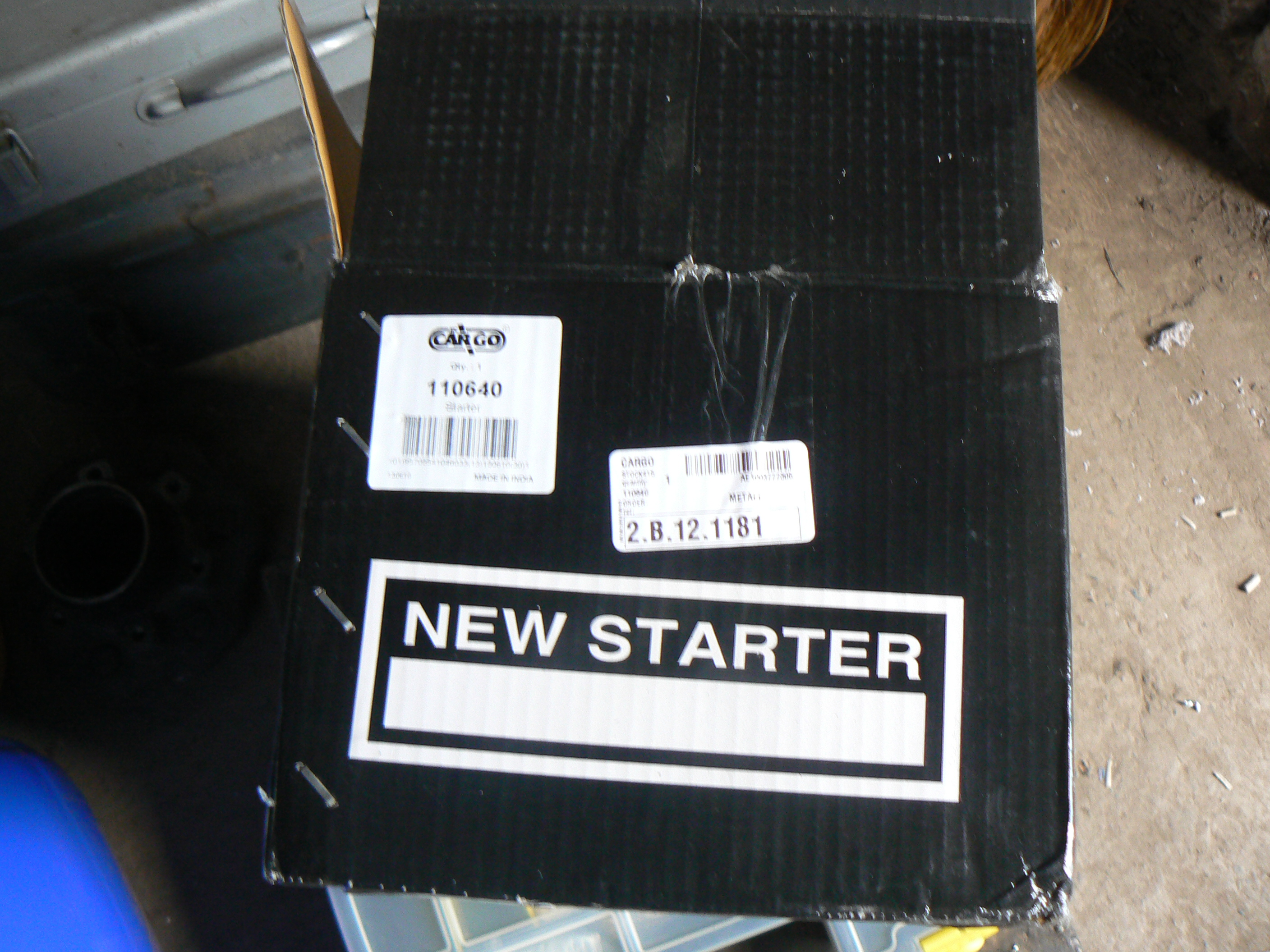

Was ordering two starters:
Cargo 110640, 3.0kW, DD, sideways solenoid, full iron :), Holland (truth, is made in India). Very weighting! Cost ~ 200$.
Full analogue for it - WAI 17184N, WAI 18029N.

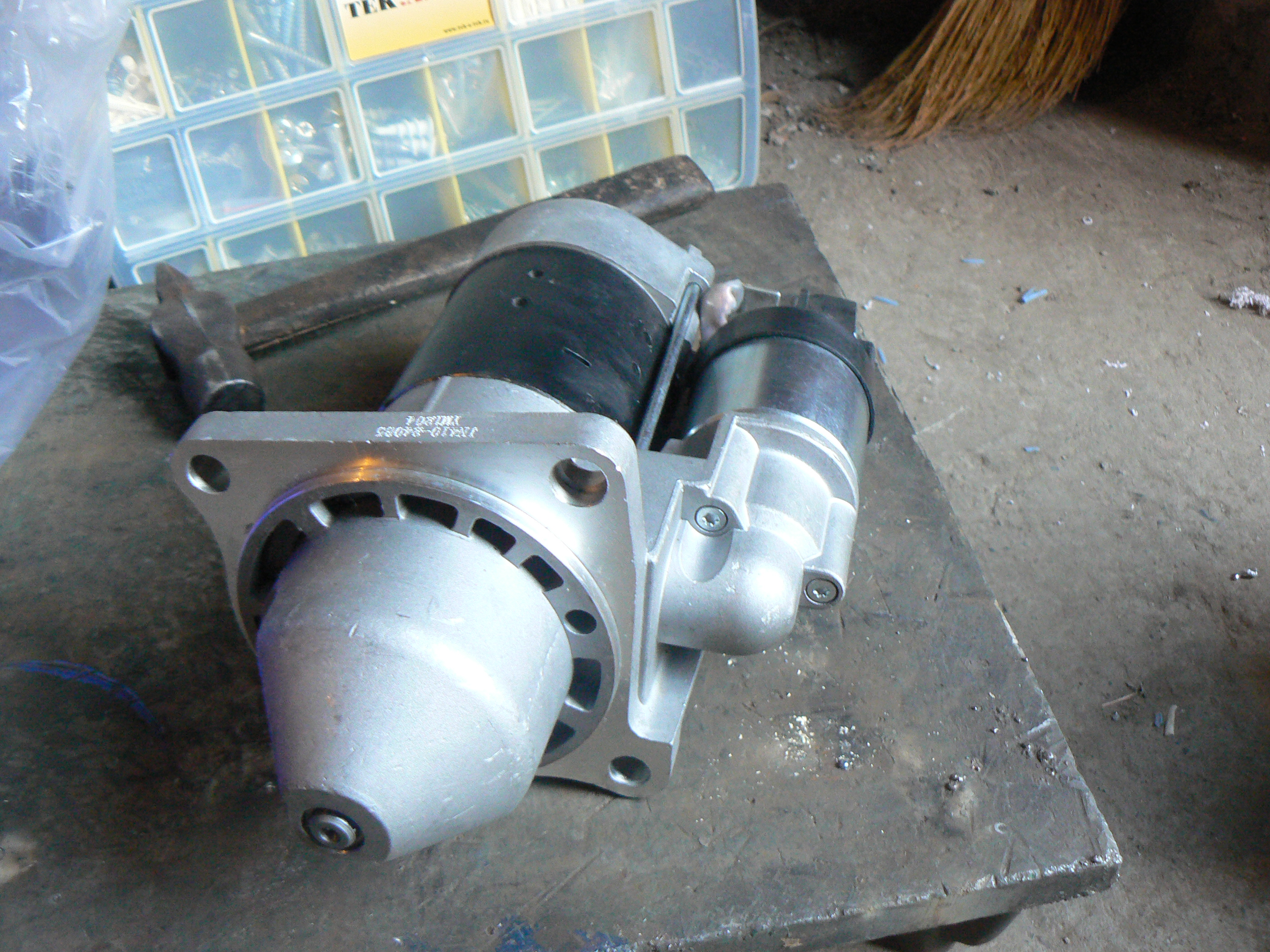

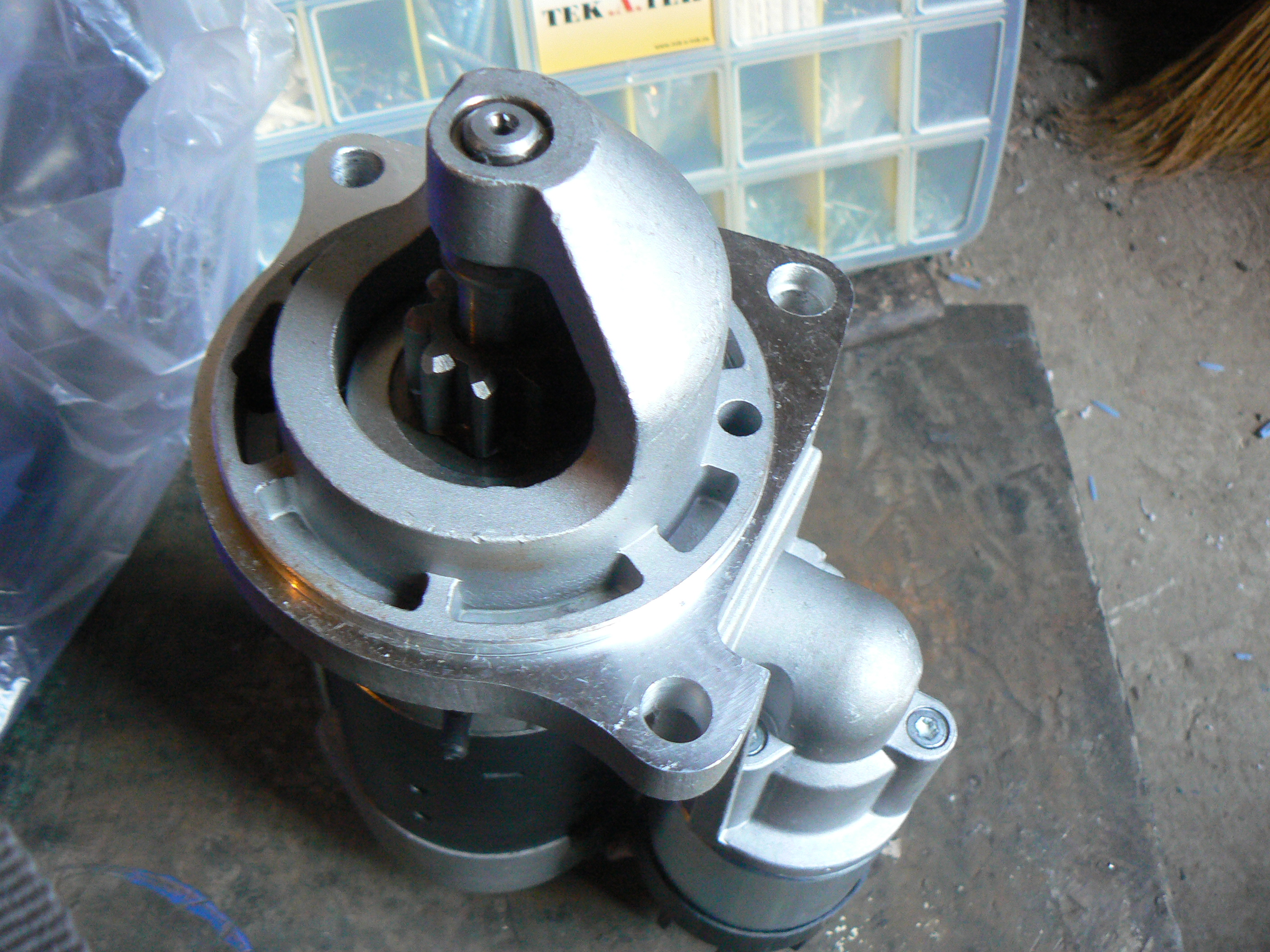

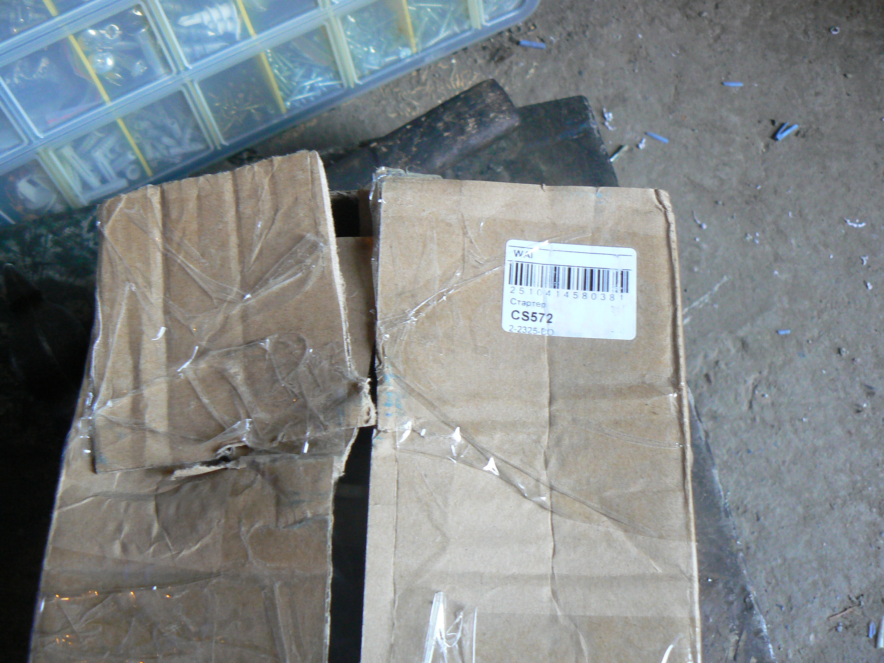

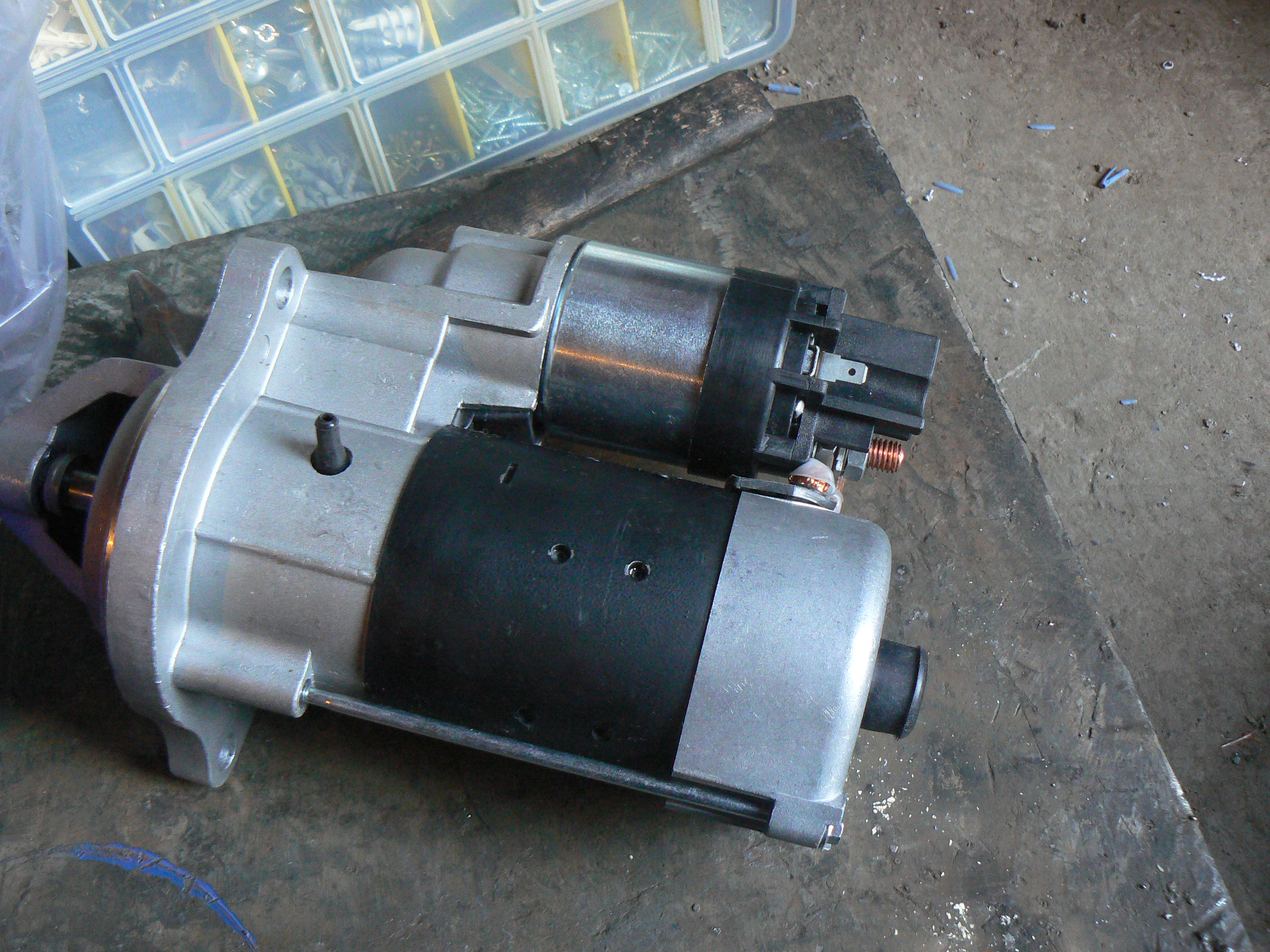

Second - WAI 2-2335 BO, 2.7kW, DD, sideways solenoid, partly aluminium, more easy, unknow made (taiwan? china?).
Cost - 130 $.
Full analogue: HC-Parts CS 572 (but it - 2.5kW).
It - for experiences, for checking reliability.
