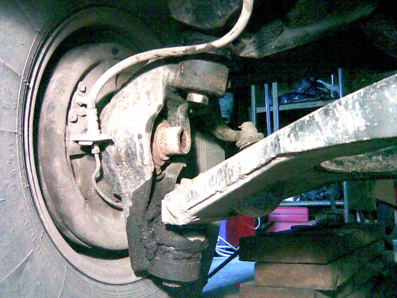

Iata ce am facut cu suspensia "clasica" de ARO :mrgreen:
 Post subject: Re: Suspensie fata modificata
PostPosted: Sat Oct 31, 2009 8:45 am
Asa arata asamblat :geek:
