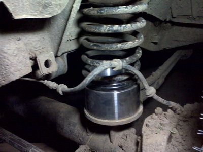

Post subject: Re: ARO 244 - Army Posted: Tue Apr 19, 2011 7:48 am |
Joined: Wed Sep 09, 2009 12:36 pm Posts: 335 Location: IASI
Pina la urma am facut flansa pentru arc de 7cm.

tudop
Post subject: Re: ARO 244 - Army Posted: Tue Apr 19, 2011 8:04 am |
Joined: Wed Sep 09, 2009 9:47 am Posts: 498 Location: IASI
Ziceai ca tre' sa fie gata la amiaza, dar vad ca ai facut poza pe intuneric

cabestan
Post subject: Re: ARO 244 - Army Posted: Tue Apr 19, 2011 8:59 am |
Si la flexare mare mare, nu se duce si nu sare?
RUDY
Post subject: Re: ARO 244 - Army Posted: Tue Apr 19, 2011 9:44 am |
Strungarul lenes  ,are buza pe interiorul arcului 3 cm,nu are cum sa sara.
