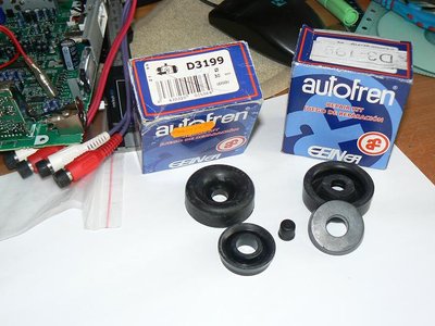

PostPosted: Thu Oct 29, 2009 11:21 am
Seinsa D3199 – repair kit, wheel brakes cylinder, diam=30mm;
Seinsa D3210 – repair kit, slave clutch cylinder, diam=30mm;
Seinsa D3036 – repair kit, wheel brakes cylinder, diam=28,6mm
Seinsa D3035 – repair kit, wheel brakes cylinder, diam=25,4mm
" the information on the catalogue SEINSA AUTOFREN
" the address: ELIZGUIBEL s/n (ESPAÑA), EUGUI, 31638
" the telephone: +34948304031
" a Internet - site: www.seinsa.es
