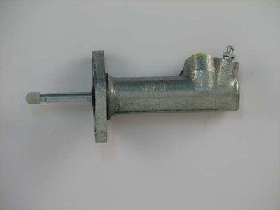

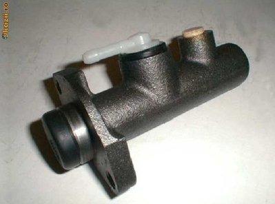

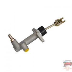

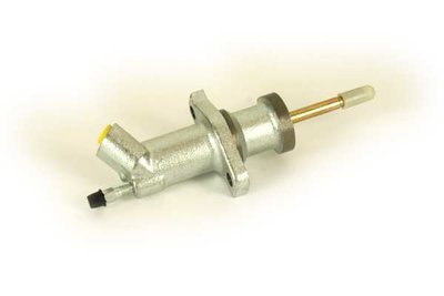

Dupa multe probleme cu pompa de ambreiaj ma gandesc sa o schimb cu ceva strain.
Cateva linkuri ca idee:
- Mercedes: http://www.pieseauto.ro/cilindru-ambrei ... 79703.html
- Fiat: http://www.okazii.ro/catalog/55333336/f ... -05mm.html

Probably just replaced the master cylinder, is not possible.
The reason for this:
Diameter master cylinder ARO - 25mm, slave cylinder - 32mm, the ratio (gain) - 32 / 25 = 1.28.
The vast majority of the master cylinders, not ARO, has a diameter - 3 / 4 ' or 19.05mm, at least 13/16' (20.6 mm). Gear ratio will be 32/19 = 1.7. This is much larger than the original. The pedal will is very" easy ", but can not enough pedal stroke to actuate the clutch.
Output, in this situation - to change the master and slave cylinders "in sets". Use the kit can be from different models and even different brands of cars.
Typical dimensions of the slave cylinders:
3 / 4' = 19.05 mm
13/16' = 20.6 mm
7 / 8' = 22.2 mm
15/16' = 23.6 mm
1' = 25.4 mm
Even in version - the master of the 3 /4' , slave 1', the ratio will be 1.3 (3)
that is a realistic value.
