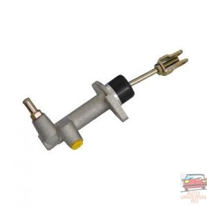

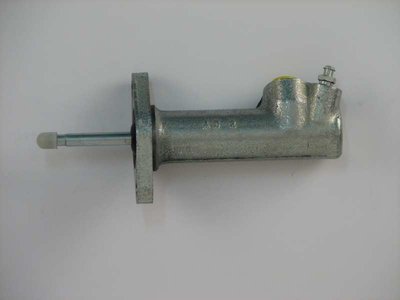

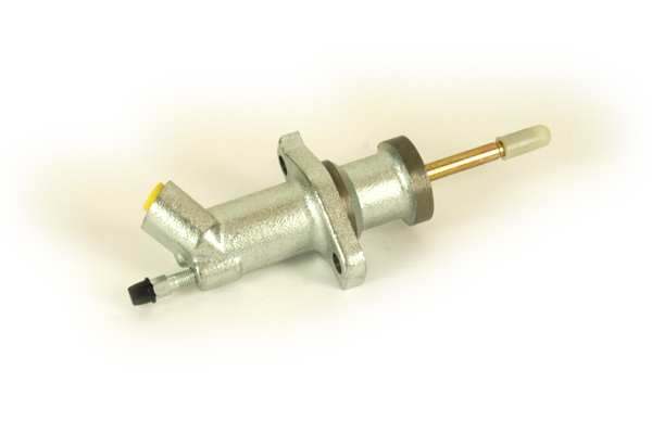

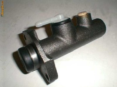

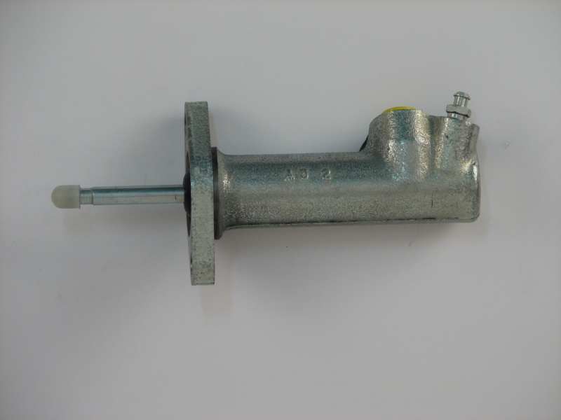

Dupa multe probleme cu pompa de ambreiaj ma gandesc sa o schimb cu ceva strain.
Cateva linkuri ca idee:
- Mercedes: http://www.pieseauto.ro/cilindru-ambrei ... 79703.html
- Fiat: http://www.okazii.ro/catalog/55333336/f ... -05mm.html

Probably just replaced the master cylinder, is not possible.
The reason for this:
Diameter master cylinder ARO - 25mm, slave cylinder - 32mm, the ratio (gain) - 32 / 25 = 1.28.
The vast majority of the master cylinders, not ARO, has a diameter - 3 / 4 ' or 19.05mm, at least 13/16' (20.6 mm). Gear ratio will be 32/19 = 1.7. This is much larger than the original. The pedal will is very" easy ", but can not enough pedal stroke to actuate the clutch.
Output, in this situation - to change the master and slave cylinders "in sets". Use the kit can be from different models and even different brands of cars.
Typical dimensions of the slave cylinders:
3 / 4' = 19.05 mm
13/16' = 20.6 mm
7 / 8' = 22.2 mm
15/16' = 23.6 mm
1' = 25.4 mm
Even in version - the master of the 3 /4' , slave 1', the ratio will be 1.3 (3)
that is a realistic value.

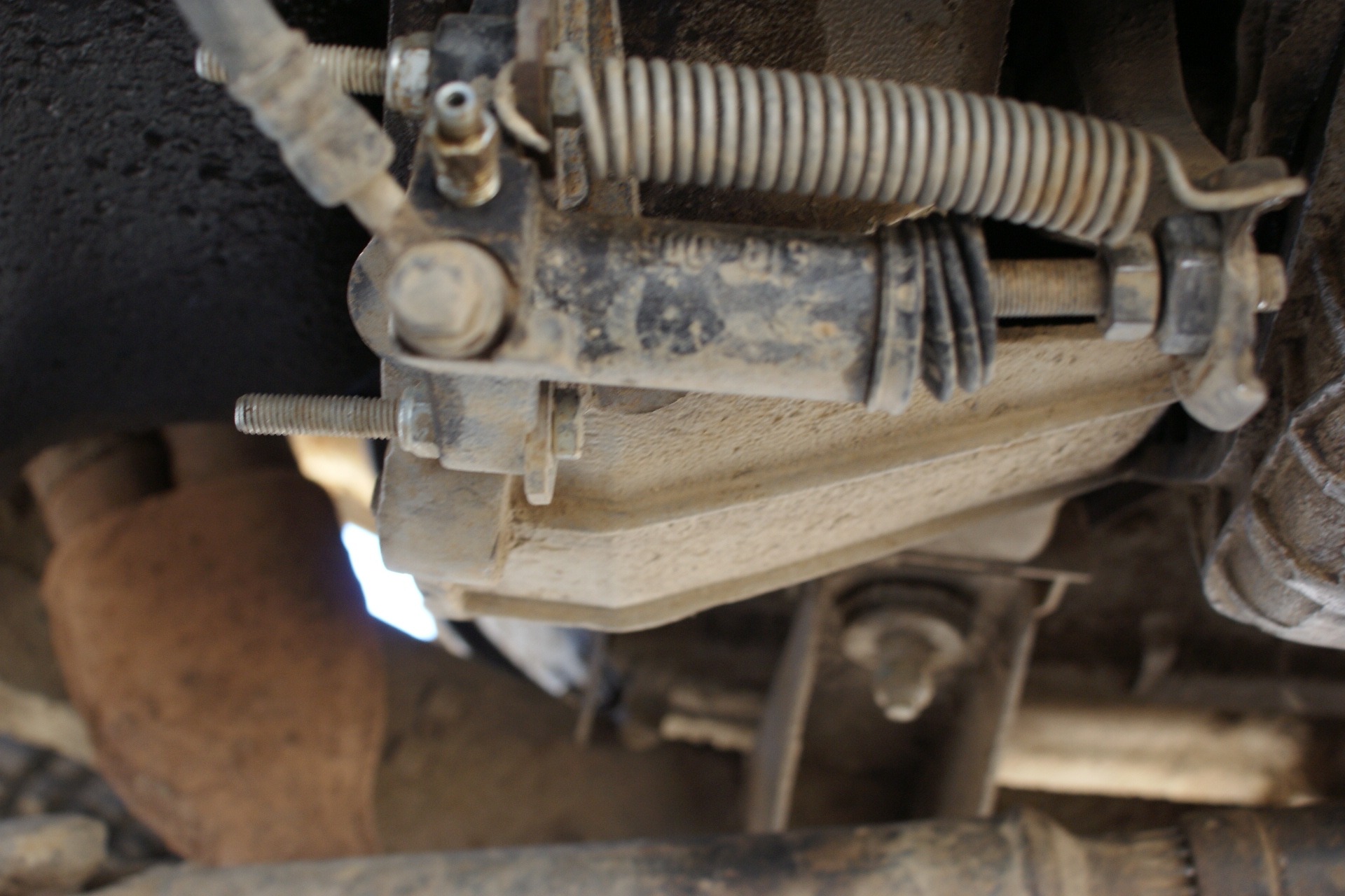

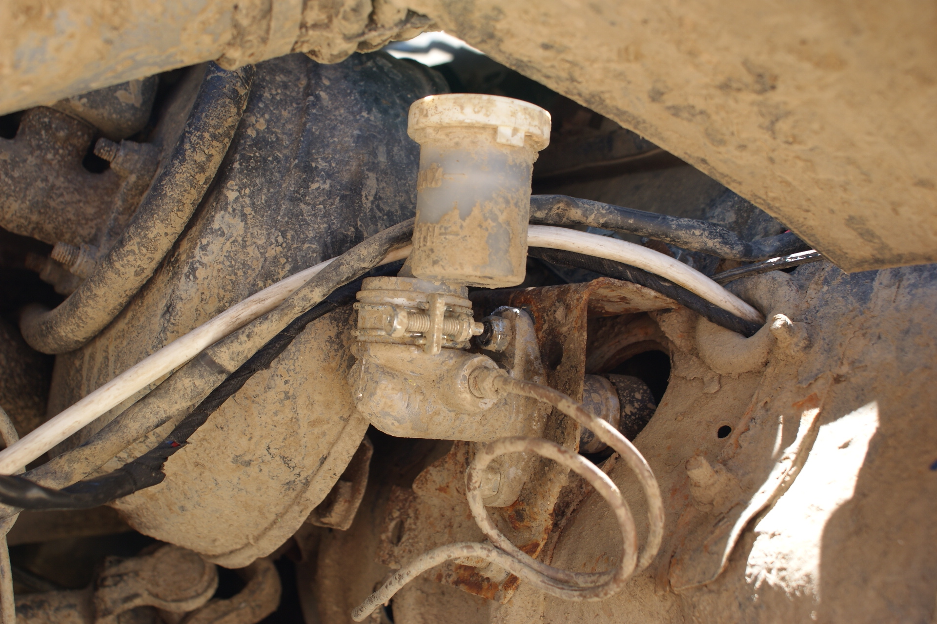

Am montat pe al meu pompa si cilindru de Pajero .E mult mai moale pedala si mai eficient.Au costat vreo 200 ron amindoua,noi.

@rudy cursa furci este destula sa debraieze si sa ramana liber si rulmentul la revenire :?: :)
 Post subject: Re: Schimbat pompa ambreiaj
PostPosted: Wed Jul 04, 2012 10:37 am
Pai se poate regla cit trebuie,ca la cilindrul de Aro.

frumos lucrat.dar oare face fata pompa si pistonasu,ca mi se par cam micutze in diametru.cum se comporta?
PostPosted: Fri Jul 06, 2012 10:34 pm
Mici da al draqu,acelasi lucru fac si la Pajero,merge mult mai usor pedala.
